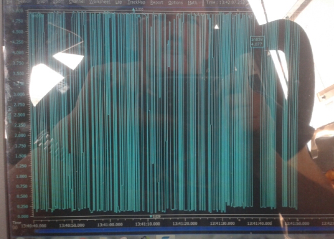

At the track and tested. Speed seems stable with the filtering, but logging on thermister / an05 shows massive fluctuations.
See pic. At constant speed or idle the voltage is flipping from 4.98 to 0.1 for example.
2015-10-03 14.08.27.jpg (224.77 KiB) Viewed 34436 times
Posts: 1422
Re: Impreza S6 PnP - Vehicle Speed / Radar - filtering
obviously the voltage at speed will be switching high and low, that's just how the sensor works.
When stationary though it definitely should not be.
