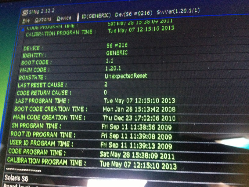

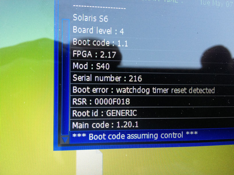

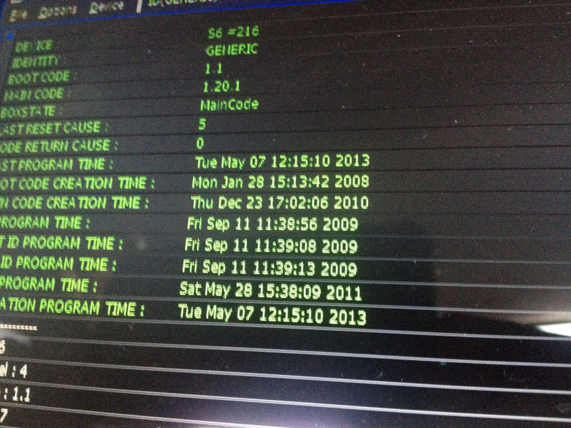

So I downloaded the syvecs software and this is what I have found.
With the ignition on but without the engine running with sMon or sMsg running on my laptop you can see the s6 will die intermittently, it will go from connected to disconnected.
If, after it disconnects I turn the ignition off and then back on again it will instantly reconnect but if I just leave the ignition on it will sometimes reconnect right away but usually takes 10-15 seconds before it resets.
I have attached 3 screen shots showing the software reports “last reset cause 5” if I turn off the ignition and then back on and "last reset cause 2" if I leave it to reset itself.
