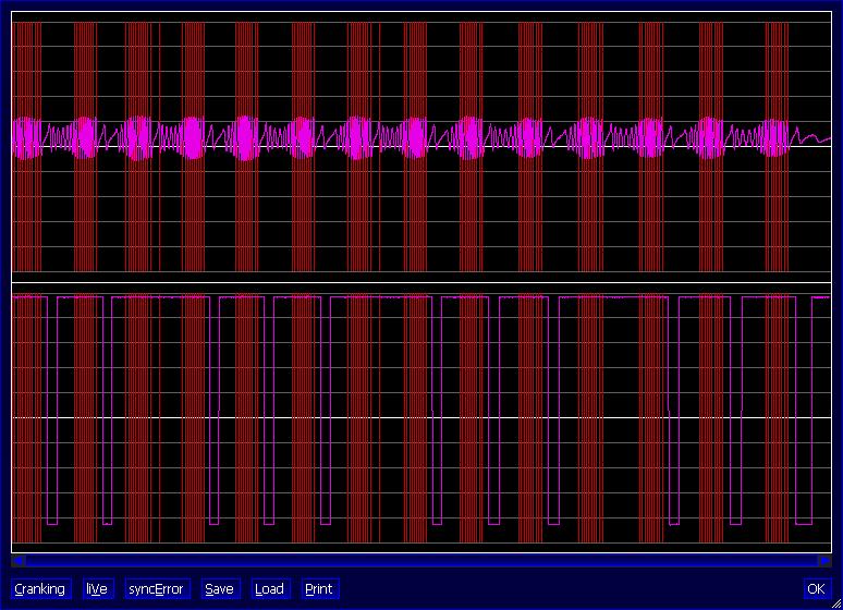

The engine cranked OK - a little bit slower, but perfectly normal. However, the engine did NOT even try to start. After some useless cranking the battery began slowly to give up, so I hooked my notebook and started SCal. Syvecs read 0(zero) rpm during cranking. I opened Sync Log and crank/cam sensor data seemed fine to me.

- CRANK.JPG (106.27 KiB) Viewed 22994 times

If you look closely at the waveform you can see the problem
There should be a red vertical line every time the waveform crosses the rest voltage, but on some of the excursions there is no red line. This is because the high threshold has not been reached, which prevents a trigger from happening. The cause will be a lower cranking speed due to the cold temp. If you go into the Sensors -> Crankshaft Position -> Crankshaft Posistion Sensor A and edit the High Trigger Threshold In Cranking and drop that down to 0.6V that should do it

Setting "High Trigger Threshold In Cranking" to 0.6 did not work. The car would "start" and then stay at cranking rpm.
I changed "High Trigger Threshold In Cranking" to 0.9 and it seems OK. Today started successfully at -18C.

The fact that the car exited cranking RPM when the trigger threshold was raised is perhaps indicative of a small amount of heat getting into the cylinders when it ran at 0.6 volts. Looking at the waveform you posted, I wouldn't expect it to start when very cold again, the positive excursions just aren't high enough, ie they don't reach 0.9 volts, but they do exceed 0.6 volts. Perhaps that was a little too low, BUT if it was unhappy then it would have simply lost sync again and stalled. Sounds like the cold start needs some work, perhaps it needs more air to get up out of cranking RPM...
