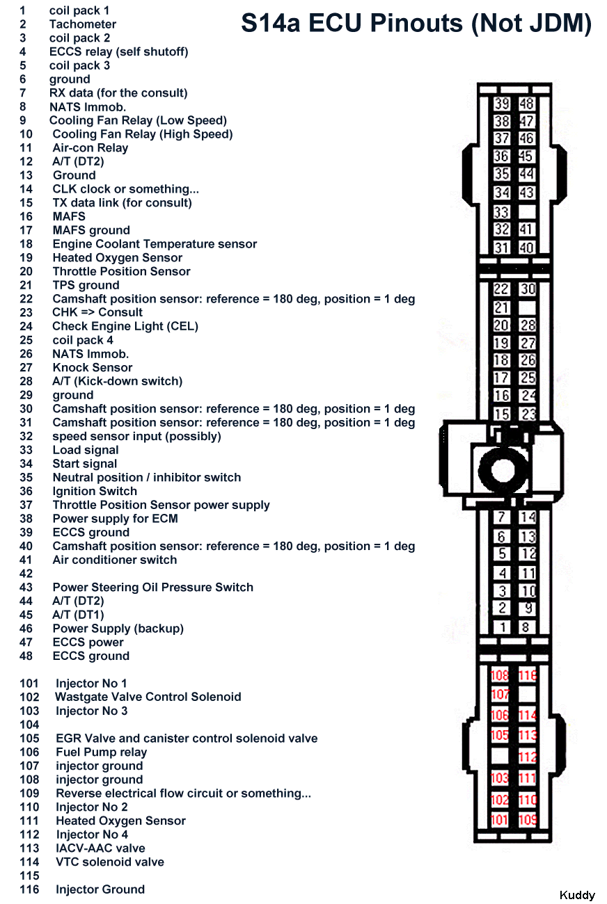

I've attached a diagram of the ECU pinouts for a UK 200sx S14a SR20DET.
Jez, does this version look correct and match the one you used to make your wiring harness?
Cheers
Dan
UK 200sx S14a ECU pinout
- s14aecupinouts.gif (133.19 KiB) Viewed 92460 times

Re: UK 200sx S14a ECU pinout
Looks ok to me - probably worth double checking in the service manual. I used an S14 loom on my engine, so the pin outs are a little different - I've passed on my wiring to Ryan
Nearly finished your Loom Dan
Need to know though abit more abit the ECCS Stuff and how the ecu power is switched on
Also can you get the exact pin descriptions of what each CAS pin does. Ie which is ground, which is signal etc
Ryan
Here's a link to the S14a Service Manual supplement
http://media.sxoc.com/contributors/petr ... manual.pdf
Hope it has the right info in there, otherwise I'll try and get the info from the club.
Looking at Page EC-23
Pins 31 and 40 are Camshaft position sensor Reference,
Pins 22 and 30 are Camshaft position sensor Position
Page EC-132 onwards has the full list of ECU pin outs....wish I'd seen that first!
Hi Dan
Info helped alot and have all the pinouts now im sure
