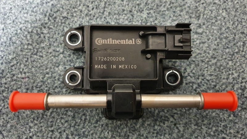

Hi All,
Looking for anyone who's got experience with the Continental type flex fuel sensors and how to spot potential fakes.
I've just received one, from what I considered to be a low risk vendor, and it arrived with a silver sticker designated SE1002S on. It wasn't adhered particularly well so curiosity got the better of me and I lifted it to reveal that, for some reason, the part number has deliberately been ground off :?
Serial batch number is 1726200208
Any opinions welcomed :D

Yes branded Continental as per the picture. There's is a QR code on the side which is just a number '60227872'.

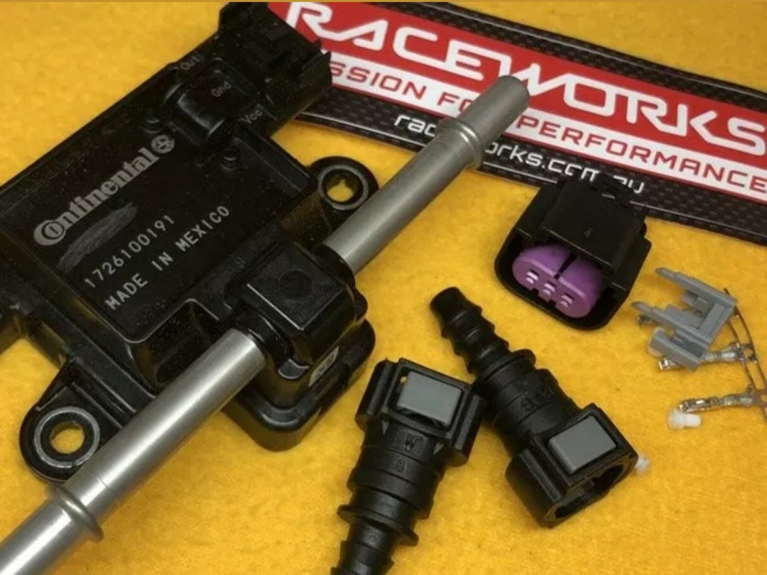

After some Googling I did find one other source on an eBay store that appears to be scored out but I can't for the life of me figure out why.
Most sensors are either 13577394 or 13577379
It was from a well known supplier so perhaps I'm being a little paranoid...

Although quality of the item in your picture looks to be good ? Plastic casting, markings etc

Some sellers just erase part numbers either so people wont google and buy elsewhere, or they may claim it's something different than others are selling.

When the fitting of after-market flex fuel sensors was unheard of, the first few suppliers bought the Continental sensor, ground numbers off, then stuck a label over it to pass it off as their own.
These days, the parts are well known, but someone somewhere obviously still thinks they are still to be kept secret :roll:

Thanks for the response Tim. Everything about the sensor looks legit, it just struck me as odd that the part number was ground off.
