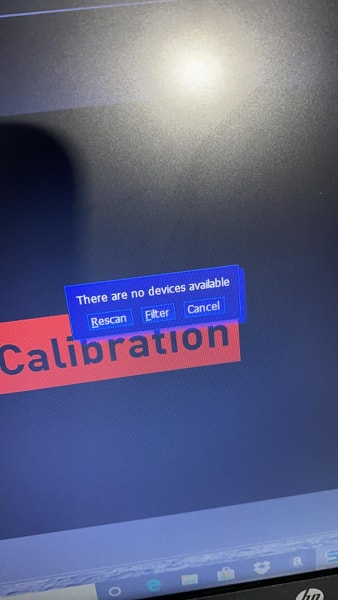

Hi Ryan
I have a 2019 RS3 and tried to connect to the ecu and keep getting the error no device found, it says no calibration so would it need a base map flashing on the bench before I can connect with my laptop?
Thanks
Banny
RS3 S7 PNP

This is all I get on any option except scfg which shows the no calibration message in the background as per the screenshot
- syvecs screenshot.jpg (31.31 KiB) Viewed 124440 times

Re: RS3 S7 PNP
If you're getting that, then either there is a comms issue, or the ecu is not powered up.
Do you get anything in SMsg or can you see anything in SMon ?
Have you ever connected to an ecu with your laptop ? Or with that ecu ? ( ie, to verify it works and is capable )

Get the same error in all SSuite apps, laptop has connected to an ecu but not this one as this brand new and only just been fitted. Why would the ecu not power up?

Re: RS3 S7 PNP
As said, either the ecu is not powering up, or there is a comms issue.
Easiest way to verify if the ecu should power up, is to check it has power at the relevant pins.
If so, then the comms/ethernet cable would need checked ( if you're sure the computer LAN port is in good working order )

Running grate now, was user error in the end
Re: RS3 S7 PNP
Plugged it in incorrectly #facepalm
