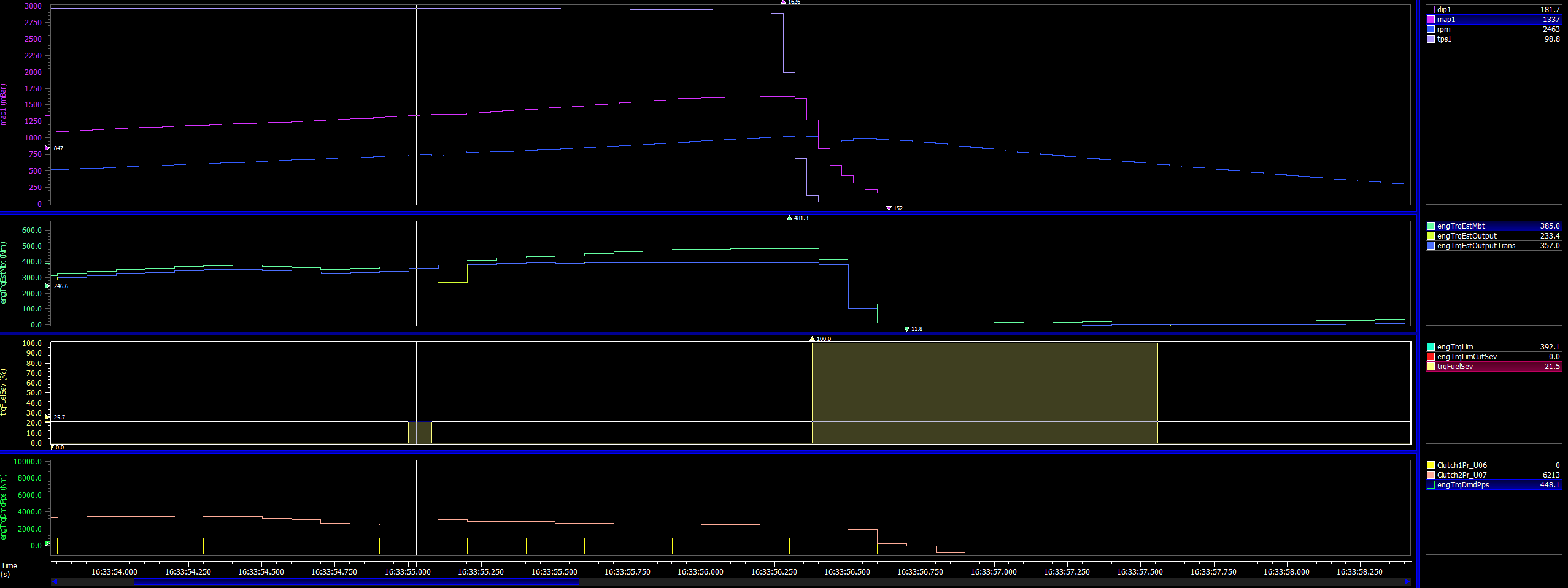

Thank you for your response. I need to figure out how to shorten the clearing time because during that time trqOutput to the trans is ramped back in too slow.
Here's a screenshot if it's helpful at all:
Annotation 2019-02-01 085008.jpg (201.22 KiB) Viewed 37869 times
