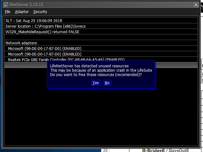

Trying to edit user definable outputs. Initially, if trying to edit the name of a Fan output, SCal would crash and I'd get this error. After reboot, I noticed that even toggling the cursor across the Output Use heading with an arrow key would cause the crash.

There's the file, in case it matters.

Upgrading to the latest SSuite should fix that. SCal 2.15.72 and 2.15.79 had various crashes when renaming calibration positions and map names.

Slowie wrote:Upgrading to the latest SSuite should fix that. SCal 2.15.72 and 2.15.79 had various crashes when renaming calibration positions and map names.
That did it. Swore I had the latest software. Thanks!
