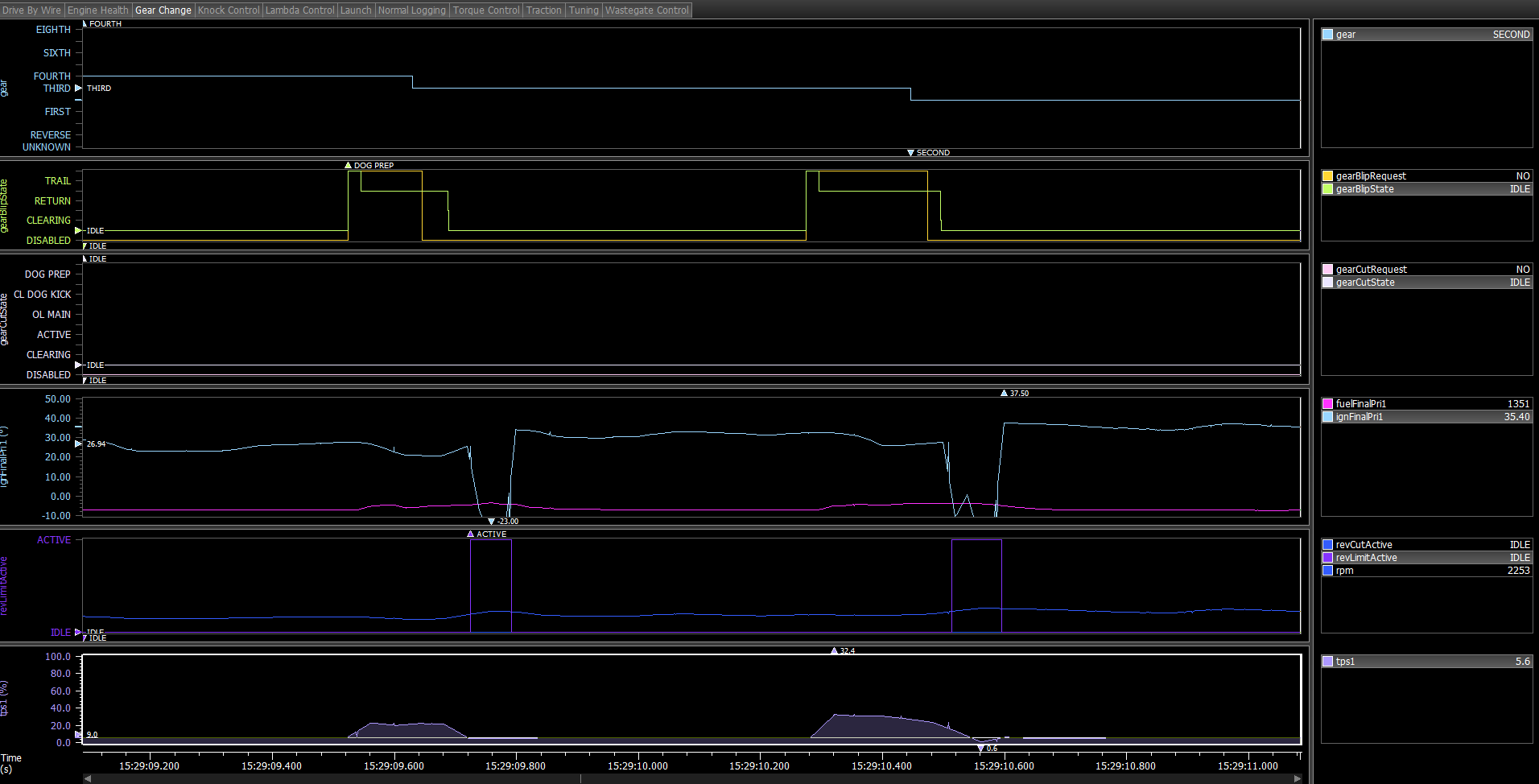

here is a log of a down change, you can see the throttle opening rpm does increase, whats odd is that i get a rev limit kick in and hold the rpm but it looks like the gear change is complete, maybe this is why the change feels so harsh?

If you are changing down a gear. Closed throttle, whether clutchless or not. At some point the momentum of the vehicle is going to try and increase the engine rpm via the drivetrain.
Of course that is going to have some "violence" to it.
Downshifts with a closed throttle have the engine rpm decreasing, but for a smooth downshift transition, you need engine rpm to increase to the ratio of the chosen gear/rpm/speed etc.

And if you are talking about a rev limit...highlight it to see what rev limit is active.

so the the rev limit is the rev hold time after completion, i can see this is too long, i will have a play and see if i can smooth this out
