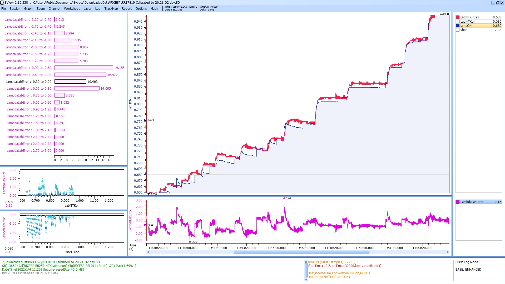

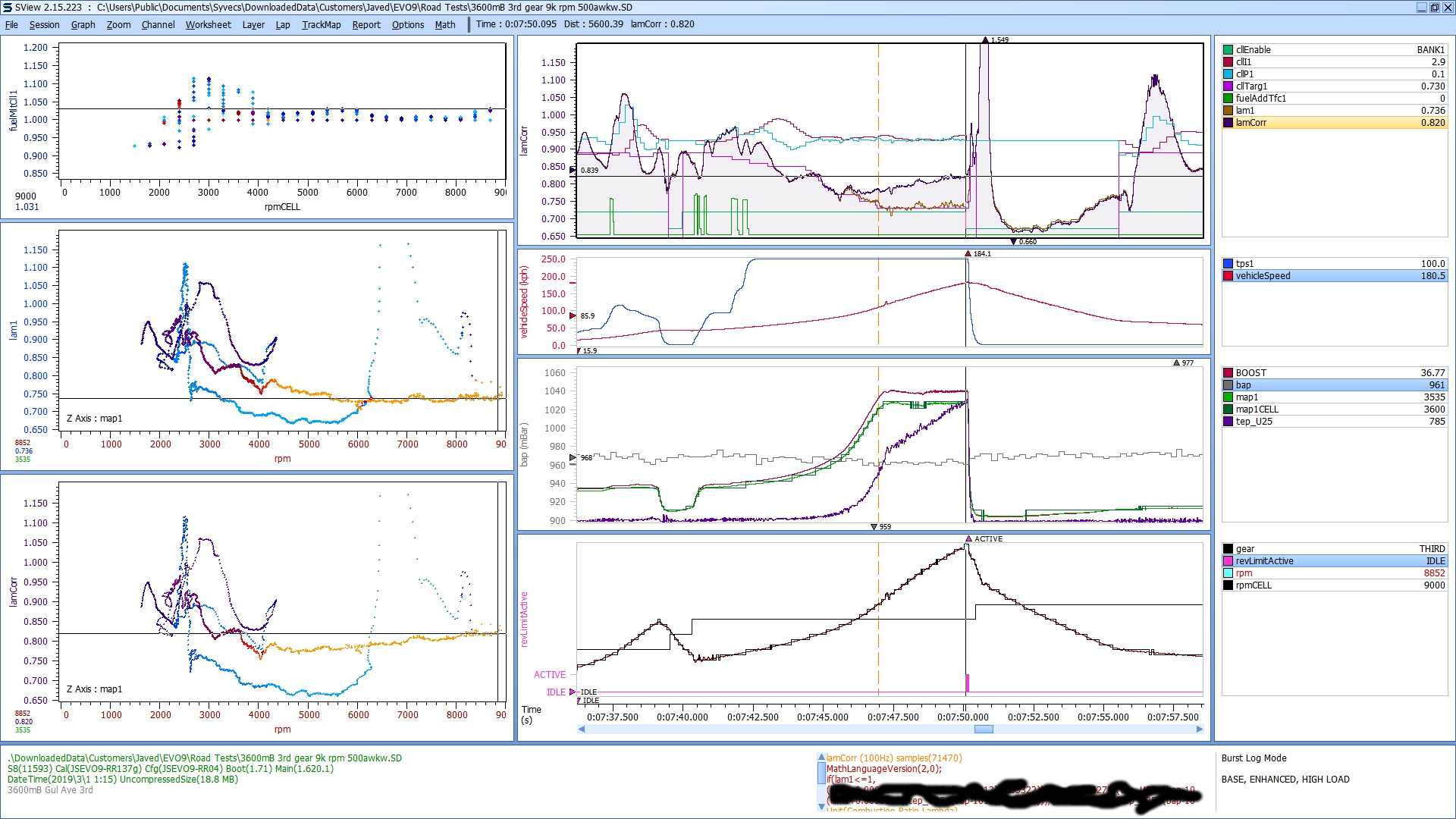

Pressure compensation, live action.
Done live via ECU/Dash or post process in analysis.

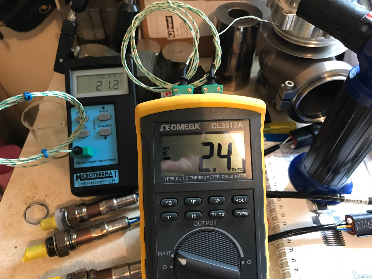

FYI to others wanting to do this (on bench). The latest firmware now allows you to keep the heater on (permanently) so no more need to keep powering up the ECU to drive the heater at 20V (max 30 seconds), also you can adjust the heater in run to a voltage to equal heater element intensity on your reference/calibration NTK meter as well.
Posts: 537
Here is a bit more detail on how to calibrate most NTK's for use in your Syvecs ECU
Posts: 537

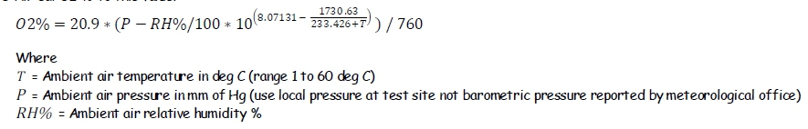

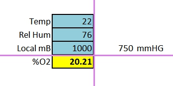

Something most don't get is the percentage of O2 in 'air' varies based on conditions.
It is pretty easy to check you just need a formula and some basic instruments and a table.

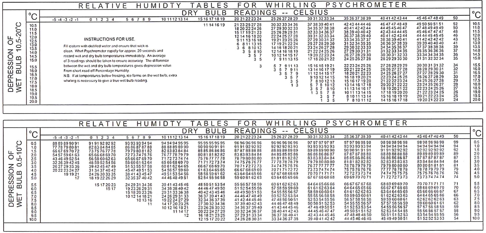

First check your relative humidity on the location where you are calibrating your sensor, simple to do with thermocouple and some water, get dry 'bulb' and wet 'bulb' reading, the delta between these two look up your relative humidity. Then get your map sensor reading for your pressure at your location, you must have localized pressure. Calculate out the percentage of O2 at this point in time and put that into your O2 instrument. If you don't do this the rich and lean spans will be out by a percentage, just as they will be in the Syvecs when you check you sensor calibration which I will display graphically below.
It's not an earth shattering difference but it is another thing to be aware of if you are flying a plane OR racing up a mountain, let alone if you are running on different days especially if the temperature and relative humidity are high V's even a constant altitude.

So here is the technical info for those who want to do this.
The errors are more extreme as you get to upper end of lean and lower end of rich scales, so if you for example dont do this or have a reference meter that is shit then it can be over 15% wrong! on a Diesel for example or on an extreme boosted engine running full rich over 7% wrong.

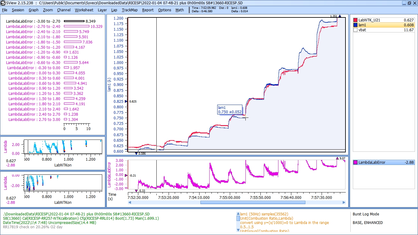

Here is the adjusted sensor report/cal test.
If doing these each day the cal is run the reference meter needs to be updated to account for test atmospheric conditions, if you want it to be ultra accurate.
For most performance car shops this wont matter :lol: as they only look at their sensor when it stops working ! let alone understand how it works in most cases !
