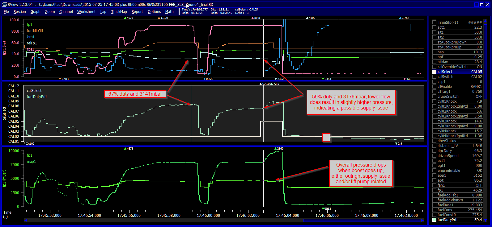

Your FP LIMP is happening because you have this set the below
3000mb relative fuel pressure (this is FP - MAP)
The engines fuel pressure in inverse of MAP, so this suggest to me you have a FUEL PRESSURE REGULATOR problem.
*possibly a leak in the line/fitting* (most likely)
If it were electrical then this would be stable until very high current draw under the effect of increasing positive boost pressure, which is not the case in your car see picture below. The relative pressure is a reverse mirror image of the MAP signal virtually.
Lucky for you this is set, which is saving the engine (Lean on load limp)
On a side note the Bosch 044 draws a 'stupid' amount of current! it really needs each pump with its own separate power feed and fuse's on each battery + feed.
They really will blow any OEM power feed easily I have found, but this I believe is not your issue as what is happening is going on at trailing throttle too, the relative fuel pressure should stay flat since it remember is FP-MAP (so should always stay at your target above 3000mb) don't confuse this with you gauge reading you are setting it too, engine off power the pumps and set to 50psi gauge pressure (= ~ 3400mb) give some margin to you rel FP trip minimum 10% is normal for example.

I think you have 2-3 problems
I believe partly the problem is caused by running 2x bosch 044 pumps at idle where you are trying to set the fuel pressure at 4 bar. At idle there is not enough flow in one FPR to regulate the pressure when 2x044 pumps are running. This means that you set your pressure at say 4 bar but when the injectors take some of the excessive flow it regulates down to more like 3.5 bar.
You may also have a lift pump problem I believe as a general loss of pressure on short bursts is accompanied by a critical loss of pressure when stringing together a a longer pull, however this coincides with an increase in boost with cal override and a loss of overall fuel pressure, so a supply issue of some sort.
A single bosch pump will do about 540hp worth of flow out the box, and about 580hp worth if you remove the original Bosch non return valve which only has a 4mm orifice through which all the fuel must flow. If you lightly pressurise the input so it's not drawing any low pressure on the suction side this rises to about 610hp worth when running 0.77 lambda.
The first step is to check the pressure with just one pump running, and the other feed blocked if a non return value is not fitted.If the actual set point is only 2 bar then you are never going to get this to work! I would also do a flow test as Andy F suggested.
