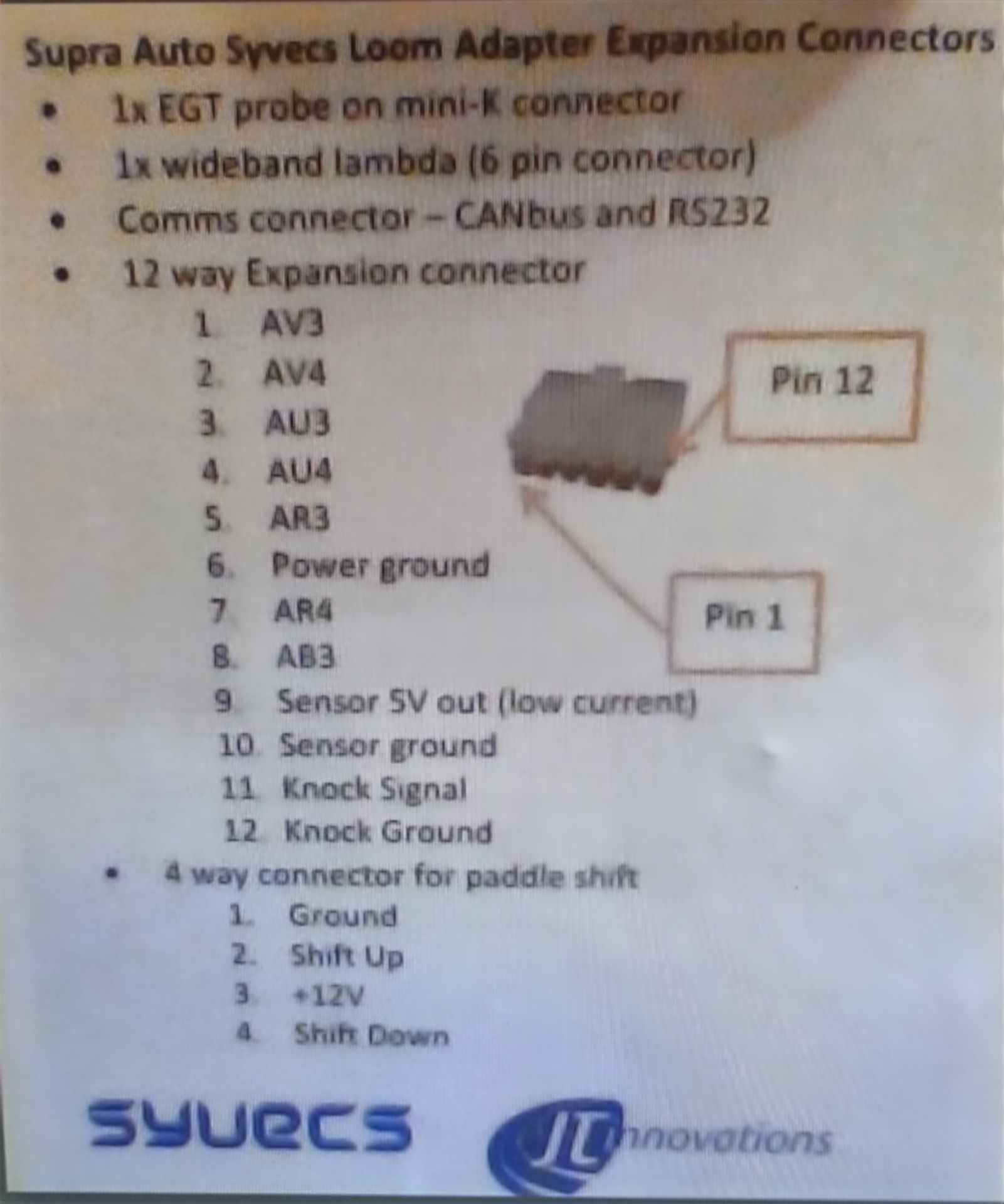

Hi Tim, thanks for your reply. I may have the wrong ecu but it is an S6 with an io expander and it is one of your loom adapters I purchased through SRD back in 2014/ 2016. I also have a small laminated card that came with the adapter that specifically mentions a 12 way connector and 4 way for paddle shift, so not a modification by SRD.
I did try scal but couldnt find the pin assignments, also didnt want to play to much in case I changed something.

Ah, my bad - I didn't check the "Auto" loom adapter schedule before replying here
Standard pinout of the 4 pin connector when I made them was:
1 (Power Ground) S6 pin 44
2 (Paddle Up) X10 input 1, pin 13
3 (Vbat) S6 pin 20
4 (Paddle Down) X10 input 10, pin 22
Hope this helps.

Thanks very much Tim, that does help a lot. It explains why the fault is intermittent as its the expander connector which is just underneath my ecu cover.

No, they are not a standard pin, but I don't have any more I'm afraid. Syvecs should do though.markssupra wrote: ↑Mon Aug 08, 2022 2:29 pmIf I need to change some pins on the expander connector, I assume you sell them or are they a standard pin?
The X10 connector is a swine to work with. When inserting pins, they often don't go all the way in but the red terminal latching part still clicks home. When you unclick the red part to sort that, the terminals can move as well, making it even worse when you put it all back together. Much swearing ensues!
My guess is that one of the related X10 terminals is not clicked in properly and you will have to fight with the connector!
Unplug the X10 and visually inspect the connector from the mating side and see if you can spot any terminals that look as if they are not in the right place - that will tell you if this is, indeed, the issue.
