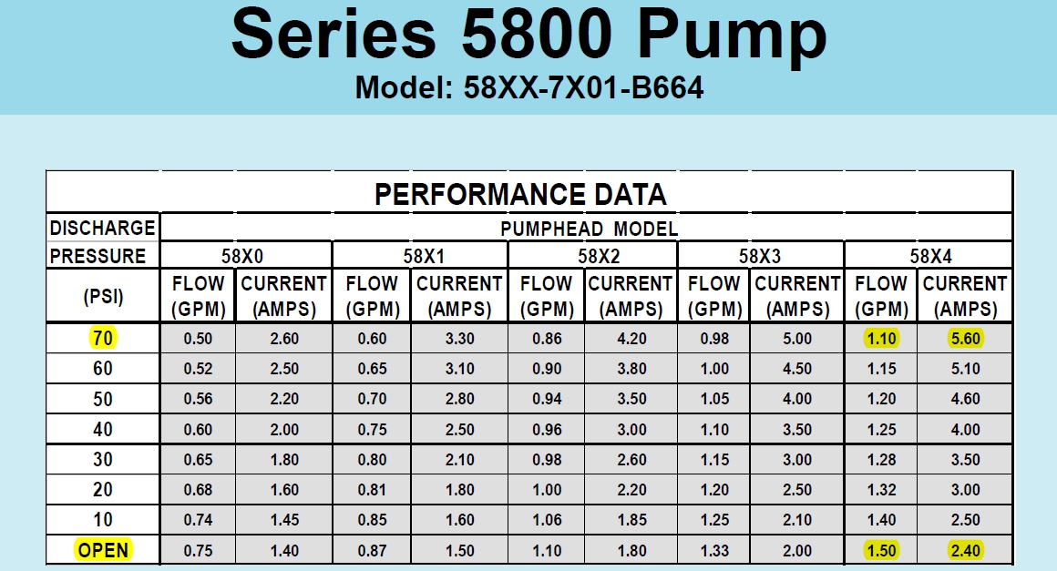

I have the 58X4 head which is the largest they make, thing to note is all quoted flow rates are on a fully saturated inlet with no losses and straight out of the pump head, this means no fitting nor delivery hose/pipe or bends, acting at zero discharge pressure 'OPEN'.
In reality the flow rates you will get in an actual system will depend on your set up, if using allot don't go off the sticker or website claims you need to actually measure it at your relative discharge pressure, same for the jet flow ratings etc, pressure and derived flow is not good enough you have to work out the actual and account for other things like the head its acting against and correct for that too. This is why really if treating it as part of your fuel delivery system then it pays to check and engineer in some extra capacity.

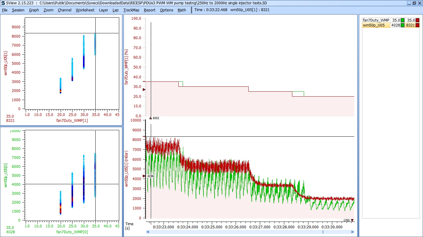

Here is the difference between the std pump used with an injector V modified, all operating variables held the same. Brings this down to an acceptable range of variation in pressure which works out to around +-3.5% volume (when looking a the peak pressure and drop over injector open time) on any cycle as worst case scenario. Tested a few different solutions some had even more smoothing properties however this was showing way too much delay in regards to response time. Most impressive thing is it gets rid of the 'hammer' that this pump head type produces, the line has a lot less vibration as too does the pump, which without any mods wanted to tear itself off the mounts even on an open flow test with nothing in the system!

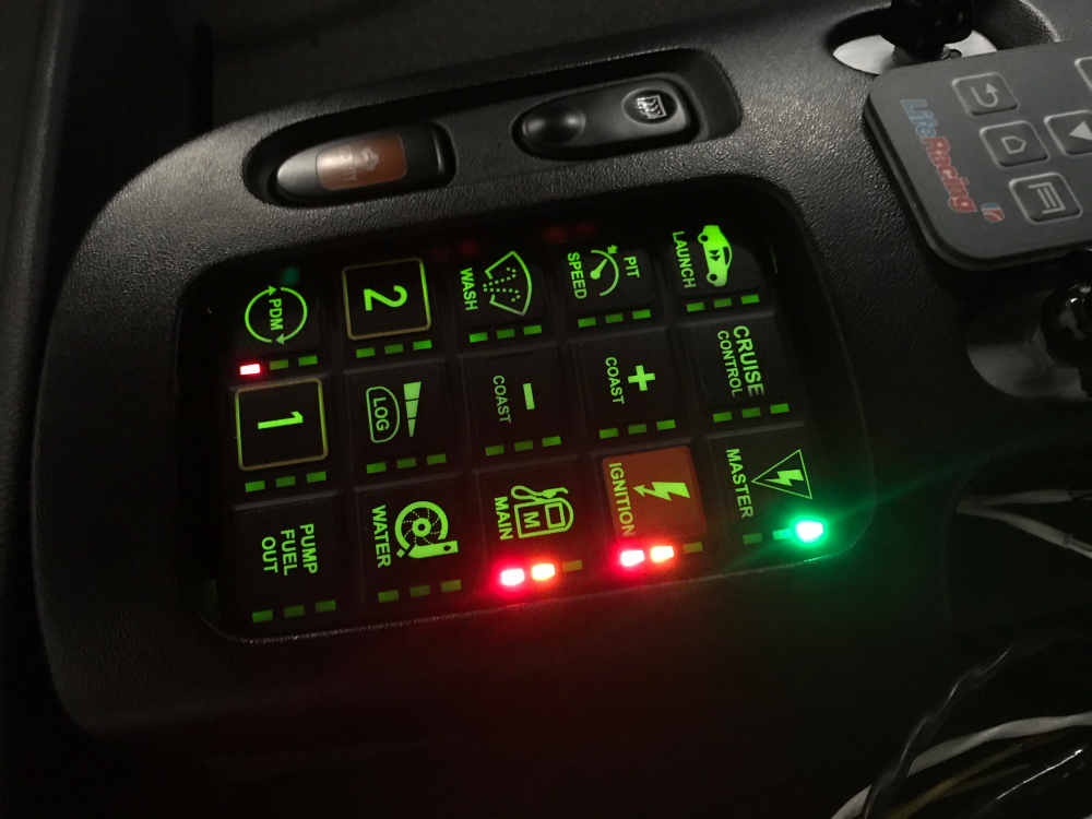

Here is a small video showing the WM pump driven by the PDUx3
and description of button programming........

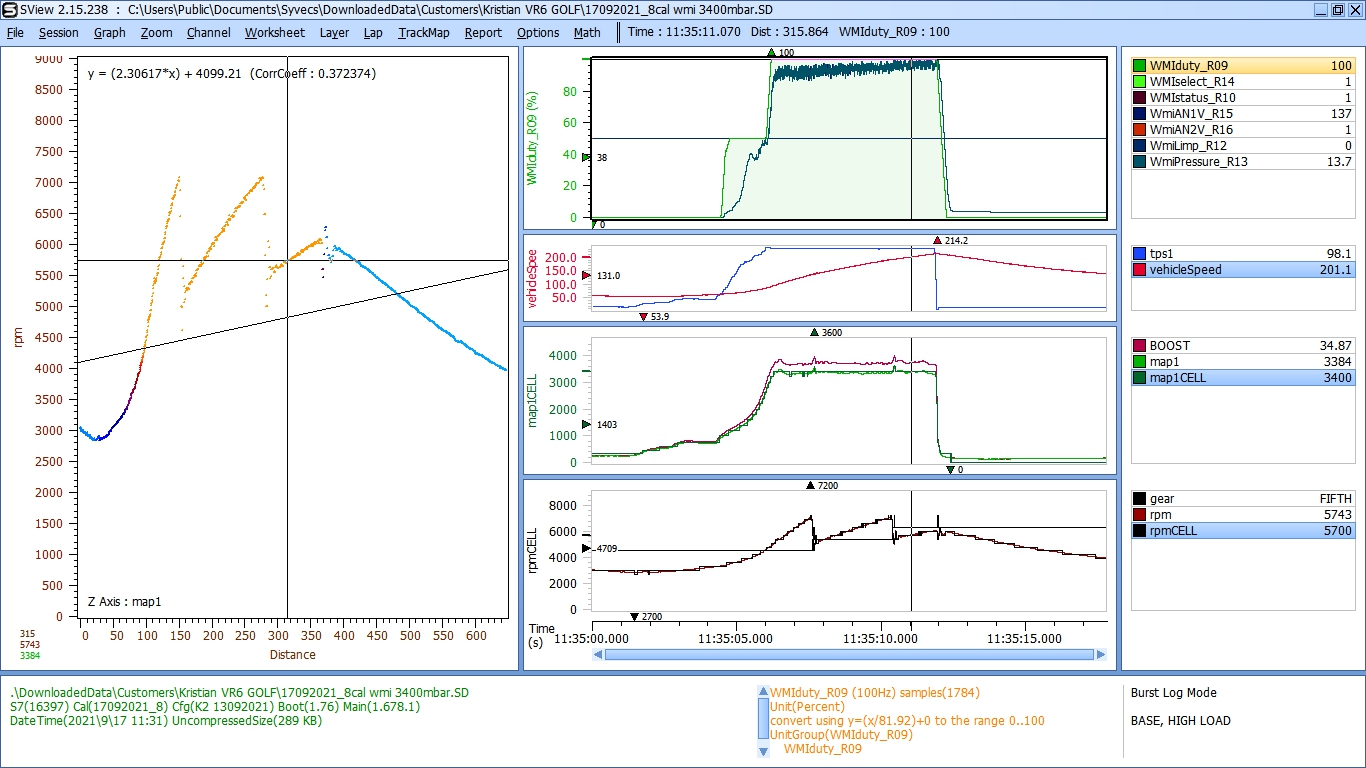

Just one quick example of the new WMI controller in action when we were developing it.
