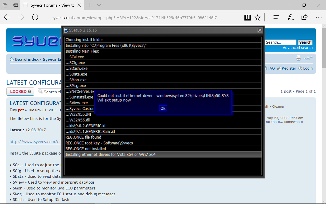

I am trying to download the new software so I can get the laptop to talk to my S6 Plus, when I click to run/install it a Blue box pops up and it says;
Could not install ethernet driver - windows\system32\drivers\LfNtSp50.STS
Will exit setup now.
I have attached a screenshot below.
Any ideas what is going on as I am computer illiterate at best.

Re: Setup 2.15.15 - Can't Install Ethernet Driver
Hi
Are you doing a fresh install, or upgrading an existing software installation? With Windows 10, I find I have to always restart the PC first before upgrading/installing, else the installer baulks when it gets to the Ethernet drivers.
Edited to add that after the restart, don't run any other software before the installer, as this may lock up the Ethernet drivers again.
Hi, It's a fresh install on a new laptop.Slowie wrote:Hi
I have just tried your suggestion (download and restart then run download) and it's moved onto another problem, the same Blue screen has popped up again but it now says;
"Could not write ExampleCalibration.SC
Will exit set up now"
Any idea what is going on?
