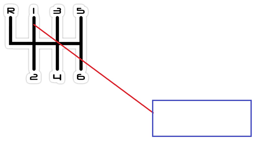

I didn't scale the pics so thy show best either on a monitor or when saved on a tablet and then viewed.

Neutral on the stick would have varying voltages as neutral covers an entire side-side gate as well as the sticks natural centre position.. I think if you could place the sensor/string in this sort of position relative to the stick, it should be able to give rising voltages throughout ( we could ignore reverse ). It would need played with before final installation, but I think somewhere down near 6th location should do.
I dont think the ecu will allow you to have voltages for each gear that do not follow a rising voltage pattern, as surely that would get very confusing for it and certainly no sequential system it is aimed at would ever be that way.
shift pattern.jpg (44.01 KiB) Viewed 10824 times
