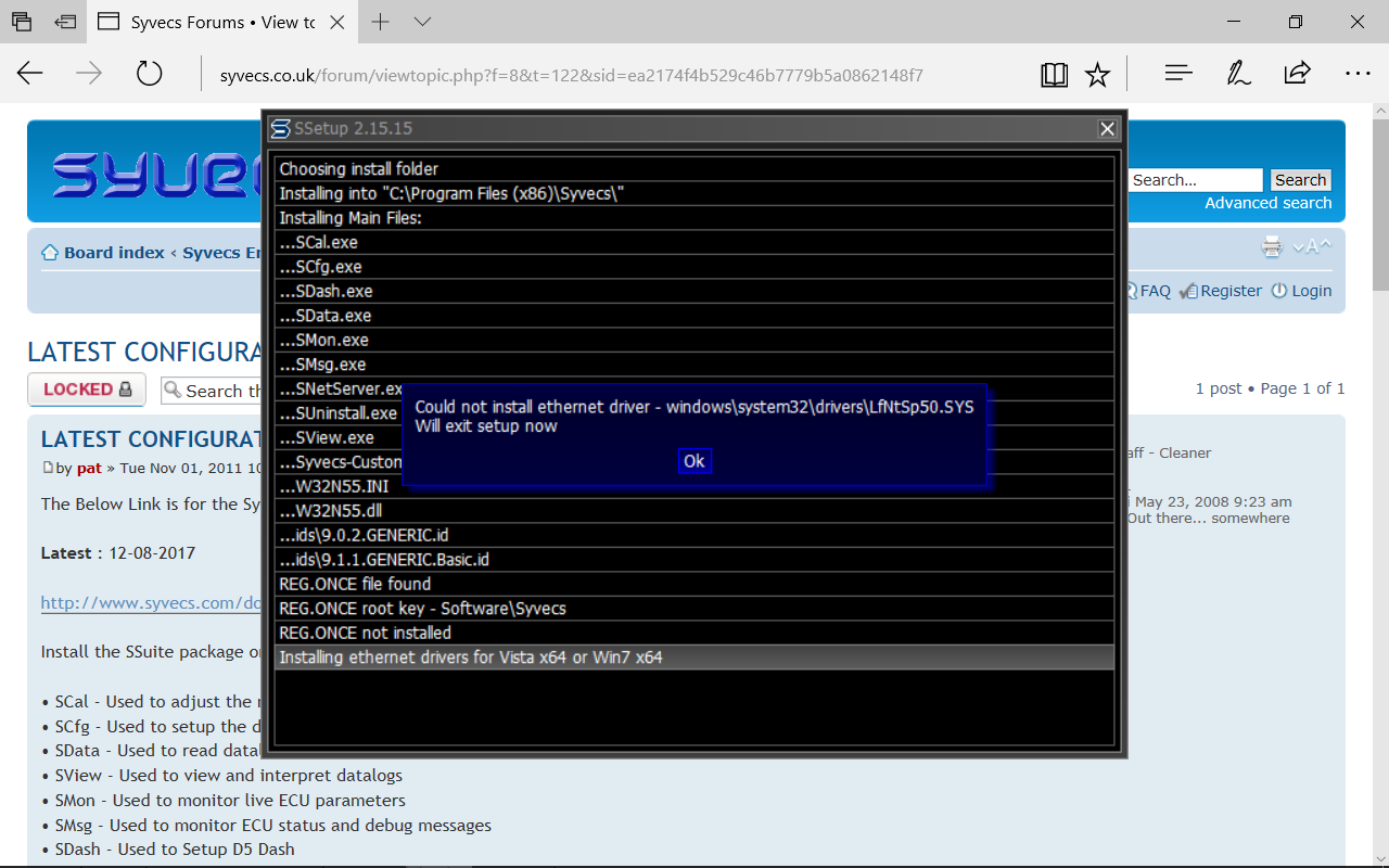

I am trying to download the new software so I can get the laptop to talk to my S6 Plus, when I click to run/install it a Blue box pops up and it says;
Could not install ethernet driver - windows\system32\drivers\LfNtSp50.STS
Will exit setup now.
I have attached a screenshot below.
Screenshot (1).png (188.76 KiB) Viewed 74985 times
Any ideas what is going on as I am computer illiterate at best.

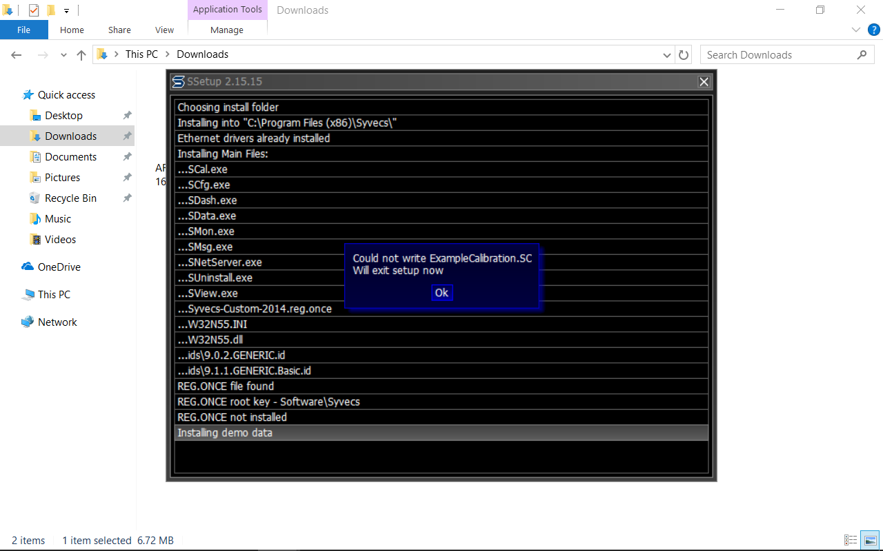

I have just tried your suggestion (download and restart then run download) and it's moved onto another problem, the same Blue screen has popped up again but it now says;
"Could not write ExampleCalibration.SC
Will exit set up now"
Any idea what is going on?

Here is a screenshot of what I am getting.
Screenshot (2).png (139.94 KiB) Viewed 74964 times
I don't think it's giving me an option to install without demo/example files, i'll try the right click run as admin now.

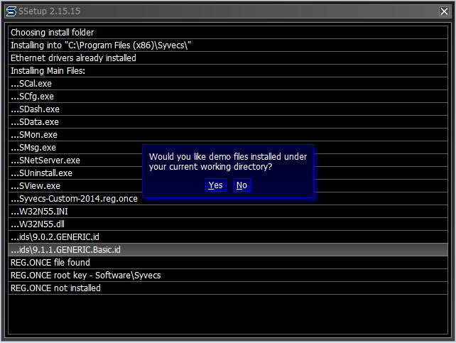

The prompt looks like this:

Slowie wrote:The prompt looks like this:
Wahoo! It's installed correctly.
I ignored the option to "install without demo/example files" (your screenshot helped, thanks) and it worked a treat. Off to the car now to run some diagnostics :D
