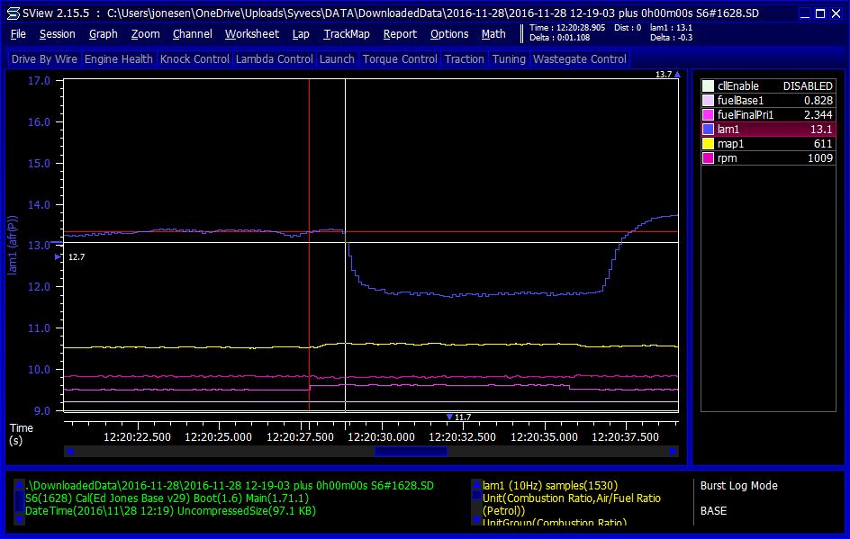

So I've begun looking lookign into tuning the CLL control and have come up against something unexpected when gathering data to populate the Service Interval
These logs are taken with CLL disabled and I've used the global multiplier @ 1.5x over a base of 1.0 to step modify the fuelling:
At 1K rpm I get exactly what I'd expect - the only question is where on the falling lambda reading am I best to measure to from the step up in fuelFinalPri1? Here I've used the moment the sensor detects the falling AFR - but of course i could use the point it levels out or anywhere in between...

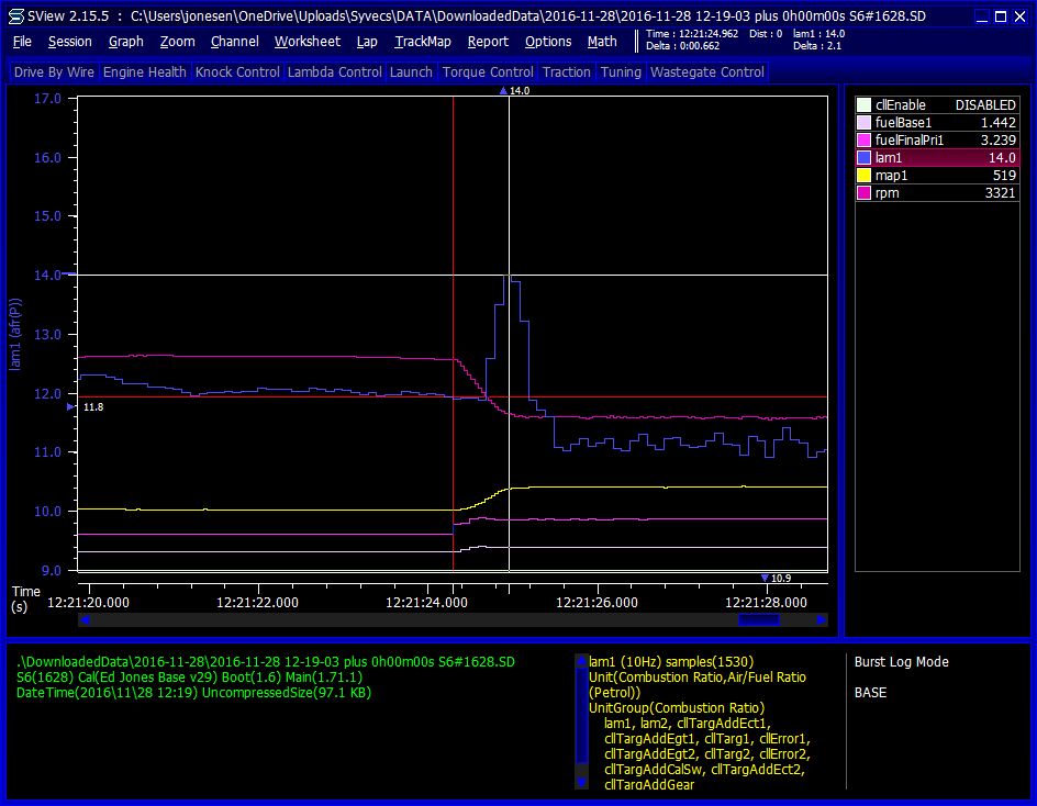

At 3K rpm I see something very unexpected - a sudden increase in AFR as the global multiplier is increased prior to the expected drop - any ideas??

Without units or scalings etc...it's impossible to see what is happening on a screenshot.
IMO look for the time difference between fuelfinal changing substantially, the a corresponding change in what is seen at the lambda sensor and that should give some sort of starting point for that load site or approx load sites.
Obviously you'll need to be logging these things quite fast, say 100Hz. Doing it at say 10Hz would be a waste of time.
Also if it is oscillating badly....reduce the amount of correction it can actually do until you have things under better control

Ah - my mistake - have now updated the plots to show AFRs at least!
Still I'm very confused about what would cause the lean spike on the 3K rpm plot when we have closed loop disabled and the step change was an addition to the fueling.
I haven't tried to repeat the experiment but will do so and at an increased logging rate - however I expect I'll see the same just in more detail all other things being equal.
This is actually shown better at the trace taken from an initial 4.5K rpm the lean spike is very visible between the initial 12.0 AFR and the subsequent 11.1 ish AFR (obviously I need to dial in the base fueling!).
Re: AFRs swinging at light load in CLL.
Posted: Tue Nov 29, 2016 6:30 pm
If the lean spike does not correspond with a relevant change in injector pulse, or more air going into the engine, maybe it is a misfire ?
Presumably the engine does run ok ? or was the lean spike actually felt too ?
Posted: Wed Nov 30, 2016 6:27 am
Transient fuel is inadequate thus 'spike leaner than target' upon rapid change in map and tps, simple way to see this is do a math channel for 'derivative tps'
where you have a rapid acceleration change in tps this rapid transient effect on air density needs a matching transient additional fuel, which you will find under that sub menu, lots of engines have differing demands dep on where injectors are located etc.... it needs to be calibrated to suit.

This was taken with the car stationary - I can't say I heard a misfire or felt anything other that the rpm drop as the AFRs went down - so the transient fueling sounds correct.
TBH I was planning on addressing transient fueling after I'd finished the initial fueling calibration - however it looks like I should likely address this now or at least prior to attempting to further populate the SI table.
