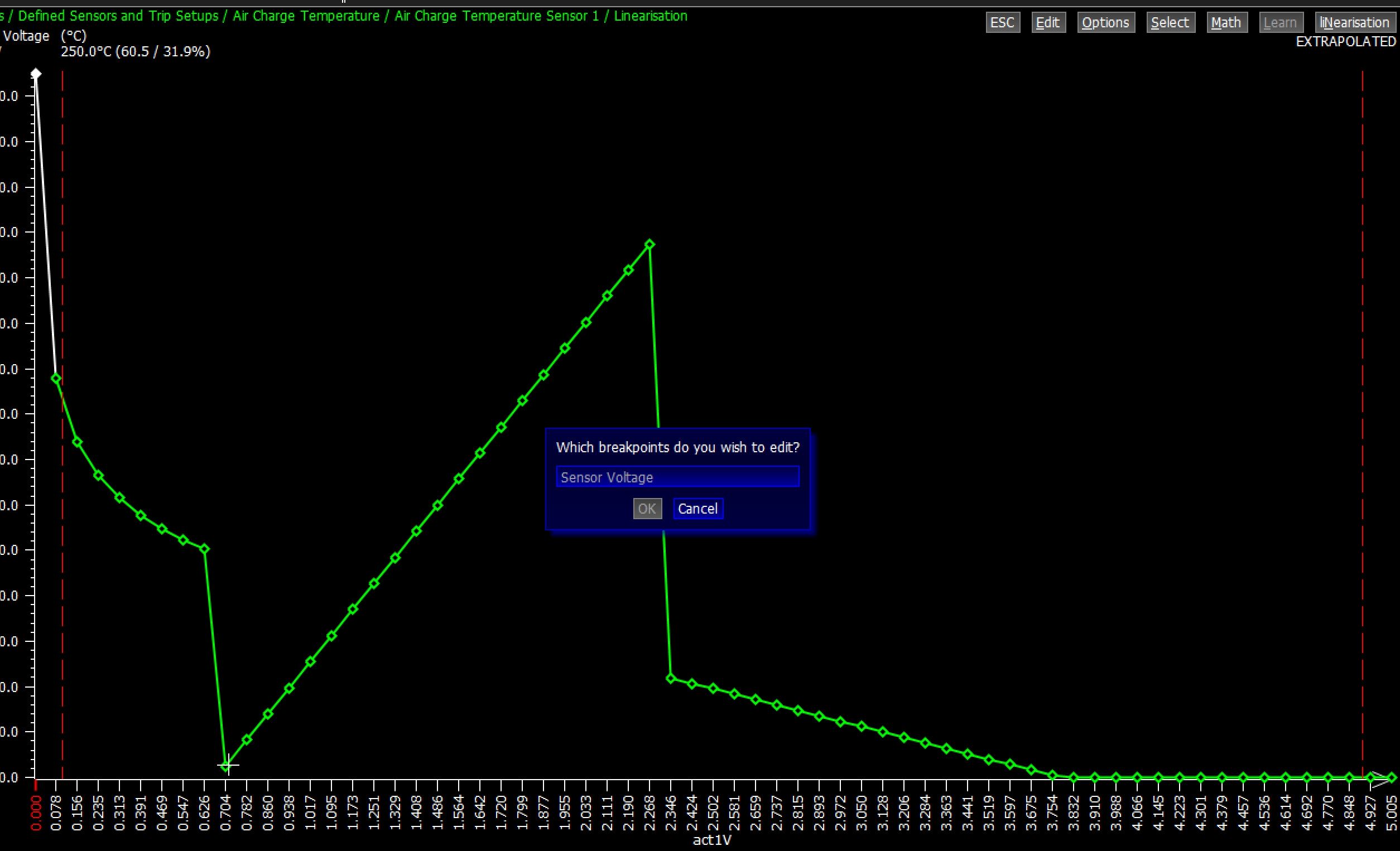

As per title - just inputting some linearization data for a temp sensor - the option to 'edit breakpoints' is there but the OK button is greyed out:
- breakpoints.JPG (253.58 KiB) Viewed 24655 times
Any ideas?

Never used that before, but if you want to edit the linearisation, first choose the linearisation type you want (e.g. extrapolation) then Edit Points from the linearisation menu.

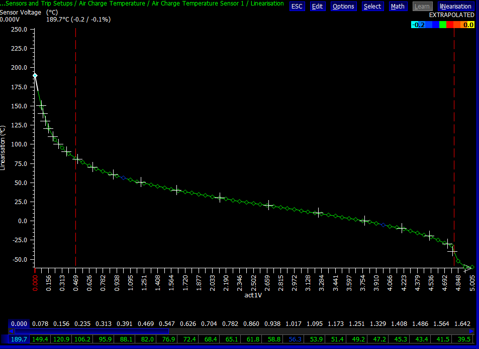

I did it the same as Tim:
Select li
Nearization, then
Select Type, select interpolated or extrapolated (or other) as required, then li
Nearization and
Edit Points, add the values you have from your sensor provider, and then li
Nearization and
Apply.
- Linearization.png (5.41 KiB) Viewed 24604 times

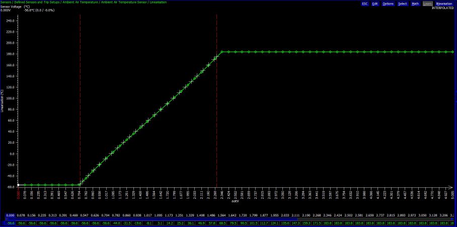

It was for my Autronic PTC air temp sensor:
Also set up my default low and high voltages - using Interpolated as the type I get something that looks like what I'm after:
- Autroic_Temp_Lin.JPG (47.88 KiB) Viewed 24611 times
