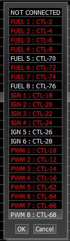

Hello,
Have the AUX1-8 (PWM1-8) output been renamed FUEL 9-16 in later releases?
Previous versions also gave the control board pin number alongside the output type and number, but in 1.69 I just see the output type and no control board number?
Older version...
- outputs.JPG (29.96 KiB) Viewed 48804 times

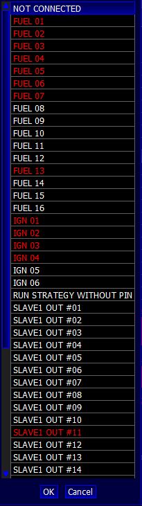

Latest 1.69
- outputs.1.69.JPG (47.79 KiB) Viewed 48772 times
Cheers,
Jezz.
Re: Output pin names, have they changed?
Posted: Sat Aug 13, 2016 8:31 pm
Funny...I'm on 1.67 and havent looked at this for a long time.
but noticed today my fan wasnt working and checked I/O to do an output test. And it's as you're describing, it just said Fuel12

Thanks both.
So I'm guessing that your fan was on PWM4 before, now on FUEL12, Stevie?
I'm in the middle of assigning outputs and I'm just after clarification that this is how the pins have been renamed before something goes horribly wrong LOL.
Can someone confirm that this is the new naming convention?
PWM1 (CTL-10) = FUEL9
PWM2 (CTL-12) = FUEL10
PWM3 (CTL-14) = FUEL11
PWM4 (CTL-16) = FUEL12
PWM5 (CTL-62) = FUEL13
PWM6 (CTL-64) = FUEL14
PWM7 (CTL-66) = FUEL15
PWM8 (CTL-68) = FUEL16
Posted: Sun Aug 14, 2016 9:11 am
I need to go back to 1.50 for it to have the old numbers, all newer versions say FUEL instead of PWM/CTL
TBH I did notice a change in the software when I did the output test yesterday, mainly noticing it was easier to correlate the two from I/O config to the output I tested
But never though much as to why it was easier.
So the new numbering makes sense within the software, even if it may slightly alter excel/wiring table setups.

I can confirm that FUEL9 is AUX1, FUEL10 AUX2 and so on.

A couple of things....
1) Yes, PWM1-8 were re-named as FUEL9-16, this happened when the S6 firmware was enhanced to allow more than 8 injectors and it was simplest to just rename them all - that way you can still choose (max 12 assigned at the mo). This is also more consistent with the S8 naming convention. The CTL numbers were dropped because they refer to pin numbers most people will never use (the 100 pin interface between the control board and the carrier).
