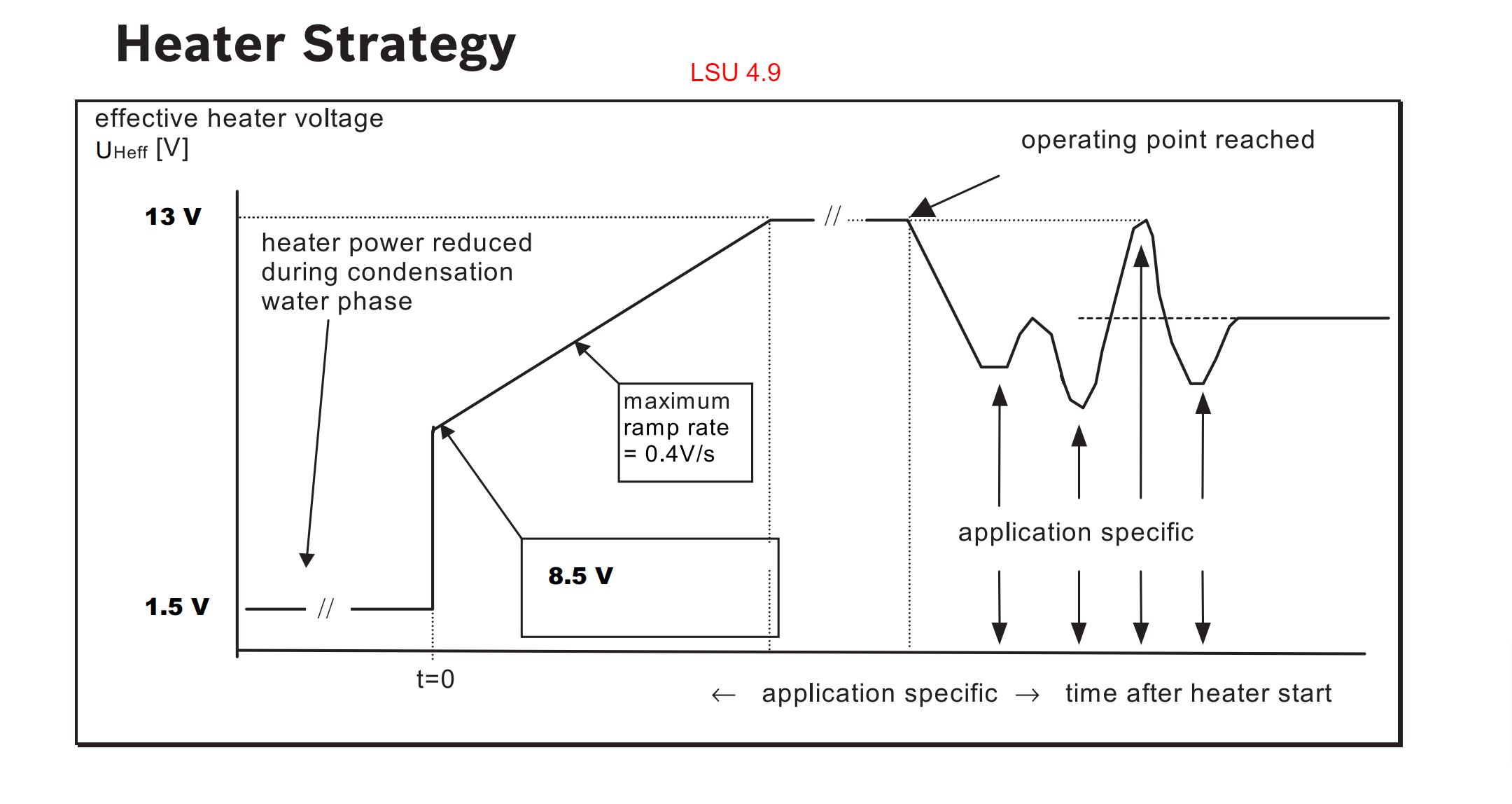

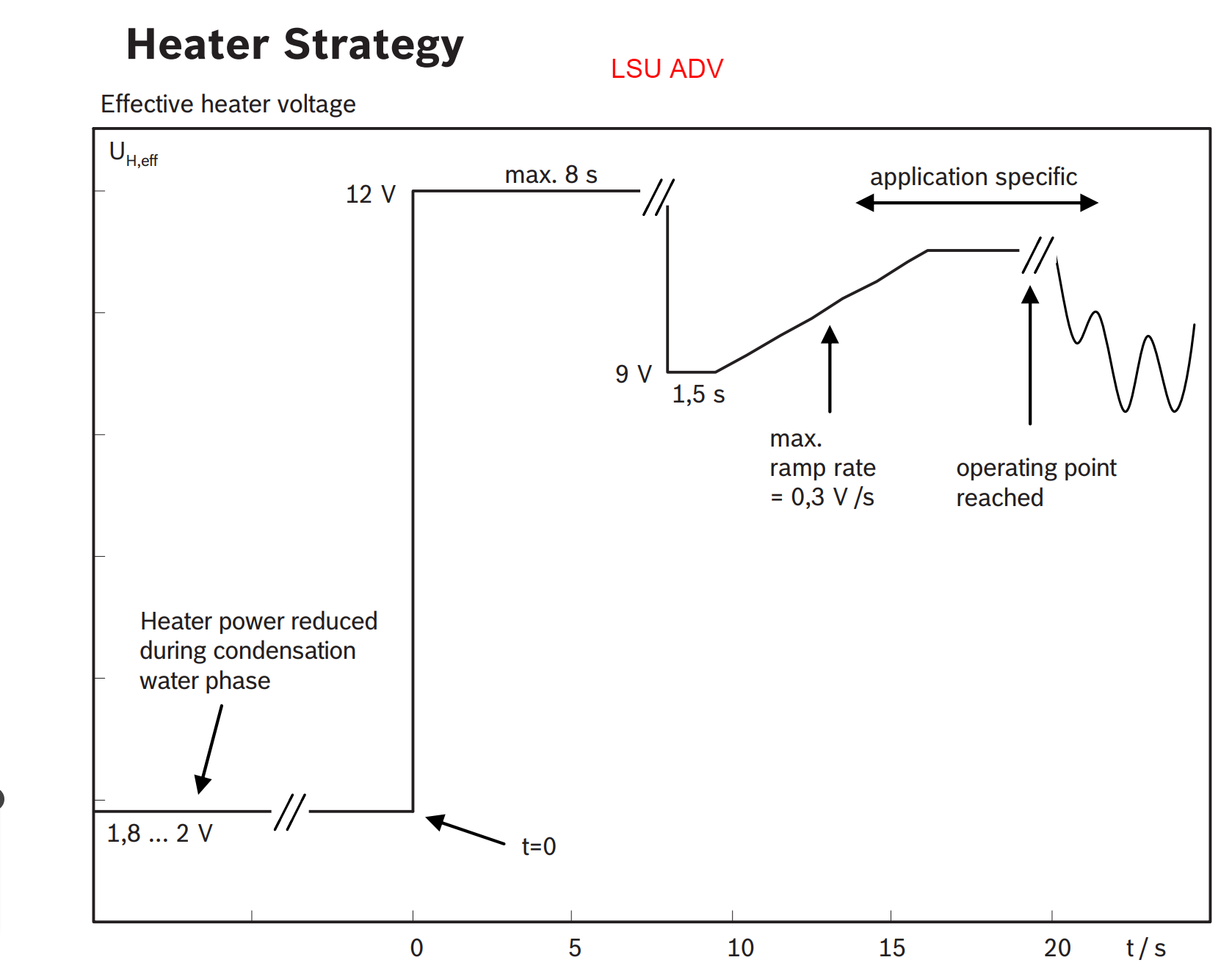

planning to have BOSCH LSU ADV pre turbo installed on N54 for dual bank setup, same time I will keep two lambda on downpipe for different debugging/troubleshooting scenarios.
Need to know how the heating strategy is configured on this ecus. according to datasheets this lambda sensor have different heating strategy.

I have checked the output functions and see there are some configs for lambda heating. However Im unable to see how I can implement something similar to what the ADV or 4.9 spec require. Both have dependency on time on startup and afterwards. Any ideas if this can be configued somehow using CM maps ?
regards
