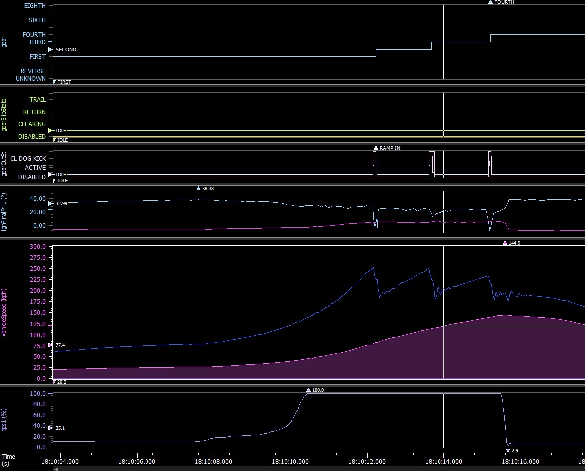

After viewing a log from another car, another ecu, regular manual low powered car.....it has a lot of wobbles.
Probably concerning over nothing really. ( and just to add, i bought the car with this ecu, I utterly despise AEM's software, and anything it is derived from !!! It will be going Syvecs soon )
aemlog wobble.jpg (586.38 KiB) Viewed 46380 times

This is more what it should look like.. Paddle shift. probably a bit of overcut on the shift. Note no significant drop in wheel speed after shift

So exactly what is the bounce, given I see it just on a regular manual car ? And from the nasty AEM log, not even always during a gearchange ?
I think it's a OE 60-2 trigger on this car.

Steve, on the Syvecs log as it is long delta and for long period after shift I would say it is wastegate if the car is turbo's, otherwise possibly lambda corrections or if is is a car with a "rubber doughnut" type universal in the driveshaft and big power maybe the doughnut is beyond it's torque limit or if it is a spring type (Standard clutch) the springs may be beyond the torque limit, clutch centre will fall out soon if that is the case. No vehicle speed, MAP or Lambda in the log so difficult to say.
AEM, sorry but who knows and who cares, mystery pack on a good day :lol:

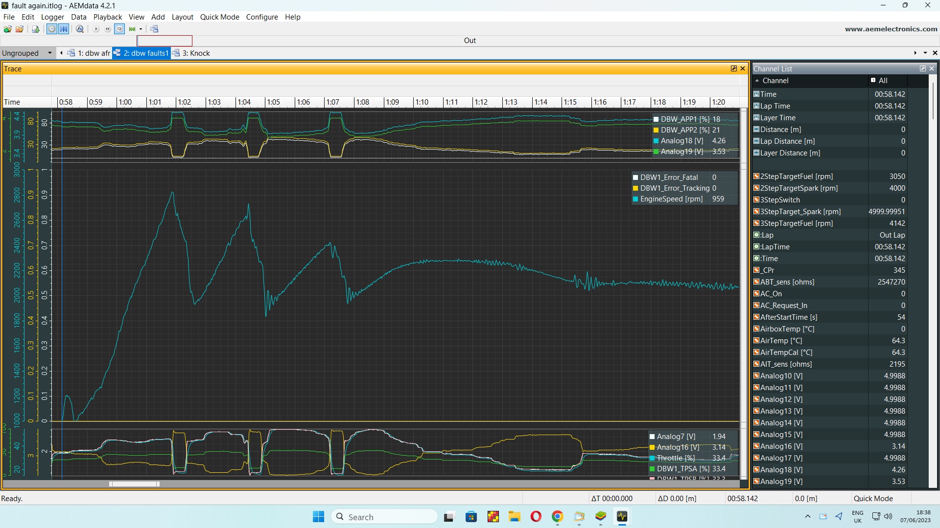

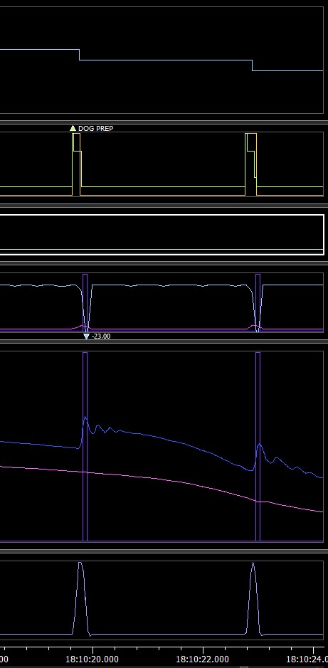

Just looking back over my logs for this issue and i just accepted that it happens, my speed increase is nice and smooth the wobbles in rpm are clear, i like the idea that is could be wastegate or lambda, i have a mega clutch in mine, twin plate carbon ceramic (switch lol) i still run the evo AYC rear diff but that is leaving soon for an LSD.
Mine could easily be trans or drive component as you can see it also occurring on the downshift.
How could we test to see if its the wastegate bouncing?
Screenshot 2023-06-26 142010.jpg (161.59 KiB) Viewed 46239 times
Screenshot 2023-06-26 143154.jpg (58.73 KiB) Viewed 46239 times
