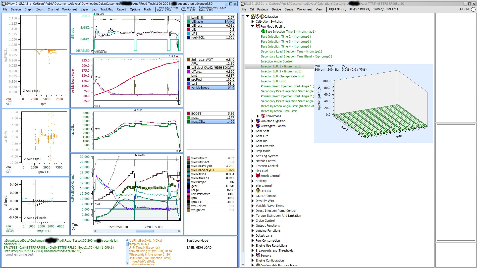

Here you go.

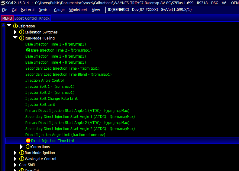

This was introduced in 1.684 so you'll need to be on that or later. Set the split maps all to 0 and set the DI time limit to something sane based on your previous logs. Between 5-6ms is probably pretty normal.
- Screenshot 2022-07-15 070659.png (70.55 KiB) Viewed 45114 times

No, that is incorrect advice.
Its direct injection time limit, set that and it will run to that max and auto put in port injection as I showed in log.
There is no need to set an injector split table when using this method, again shown in log an cal screen shot, hope that helps.

Please see my updated response. I was in a non-DI cal and thought the name was the same. Concept is the same just different name.
