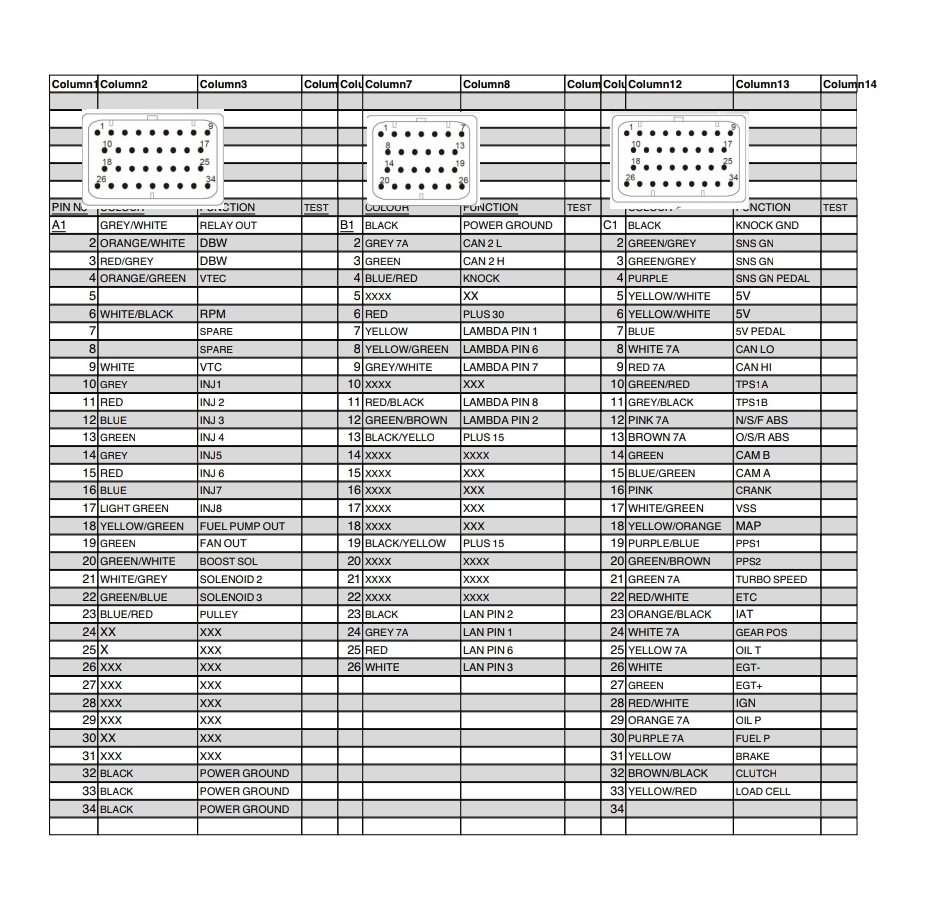

Yes went and unplugged everything from DBW to wideband, on there 3rd fuse it stopped blowing fuses but now does nothing at all still sends power to wideband when I hit ignition button buts that's about it laptop doesn't see it at all.

On what 3rd fuse ? What wideband ?
Whilst the ecu controlled wideband may receive 12v power from an ignition ( key one ) based source, it will not heat the sensor until the ecu output is activated.
Does the ecu now have power ? Pins B1 and B7, gnd and 12v respectively.
Confirm this, then confirm comms with laptop.
Although if you've unplugged stuff and the fuse is not blowing, either there is a faulty device, or faulty wiring of some sort. Hopefully it has not harmed the ecu

And I will repeat again.
Have you confirmed power/ground at the relevant pins on the B plug at the ecu ?
B1 ground, and in your case B13/B19 ? ( as you're backfeeding power to the lambda sensor from B7 )
When this has power, can you confirm either comms, or no comms ?
And as said before, I would be doing this with the A and C plugs disconnected to remove as much of the loom from the ecu as possible.
Or make up a lead/connector to bench test from a suitable 12v power supply.
If you're getting no comms and no sign of life, whatever the wiring or fault is, may have harmed the ecu. There is just no way it should be blowing a 10A fuse.
But I would not have been attempting to power it back up again with that wiring loom still attached.

Hi
Sorry yes power ground at relevant pins. No comms ,yes tried with A and C plugs out after I tried with things disconnected, maybe lack of knowledge my end but as engine was running fine and spent hours testing loom I didn't think it would be detrimental to ecu. Thanks for your help.
