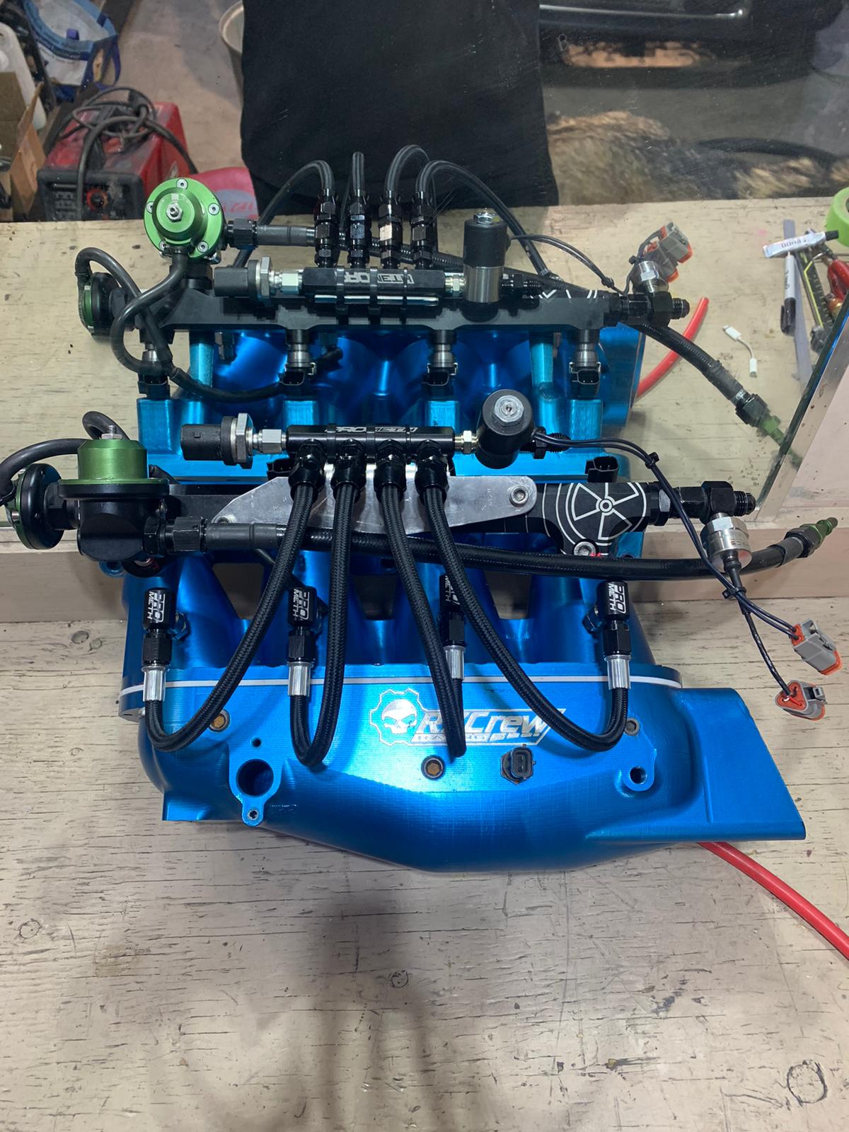

Here is a 'ghetto' set up doing with just control by Syvecs S7 ECU.
There are many ways to do WMI so if anyone is interested and does not want to do it themselves etc hit up the squirting specialist 8-)
