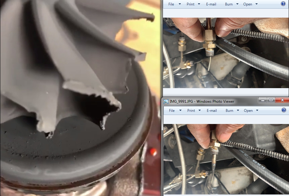

Posted: Sun May 31, 2020 9:24 am
Here is what 1160 deg C pre turbo EGT does to a Garrett turbine wheel :)
All 6 donmega Type K thermocouple probes are still working as new, despite small bend from the abuse :shock:
Great way to test durability though :lol:
