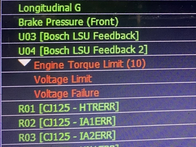

I have entered the correct data with the assistance of teamviewer and LMS. Unfortunately the car has the same issue. :(

The car runs, but not driveable on a stock startup file. Obviously I need to rid the error message. How do I figure out what signal on what pinout the Syvecs is looking for that is tripping the error messages? If I can find that out I can fix the issue as long as its not software related.

The info it needs will be transmitted via CAN. It is not a case of just 1 pin. It's data, not a simple raw voltage signal. If the CAN wiring was not correct, you'd be getting a load of errors

Still getting the trans limp mode message on dash, even with KOEO. Also still have the same “Engine torque limit” error message on Syvecs. Based on this error message also saying “voltage limit” and “voltage failure”, it must not be receiving an input signal either from a pinout/connection issue, or a software setting. I need to email Syvecs and find out what trips that message. Wish I could get an actual normal engine code for this error, I’d have it figured out already.
I would try putting the numbers in as per the named fields for Coding 01 and 02 then, even if it isnt quite "correct" as per the manual.
Any lack of signal relating to that item...will cause the trip. A generic OBD code would do nothing regardless because that is not how CAN works.
