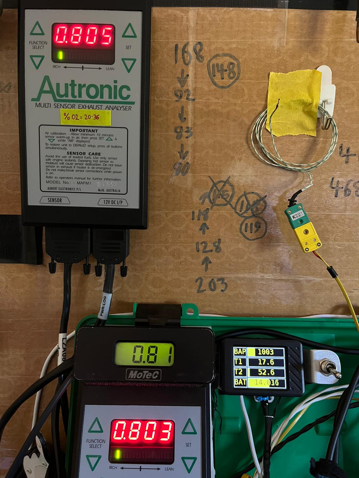

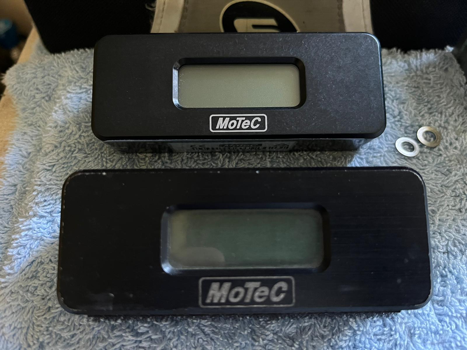

I also tested multiple MoWreC PLM'z
as most shops would use one out of the box with most ghetto set up (pretty average results as to be expected)
there are some big flawz in the way they work (unstable readingz) but as said before for hobby wannabe motorsportz they are tolerable and fit for purpose
once fitted the RR sensor and bespoke set up can be made to read in extended ranges with ease (down to 0.585L) and are not a bad unit if you are stuck with one or only listen to podz bullshit spread by shillz 'cash for comments', will be supplying sensorz for these once finished testing but as said to anyone who asks if you are serious just buy a fucking *SYVECS LAMBDA TO CAN UNIT and RR CALIBRATED SENSOR or 8 !*

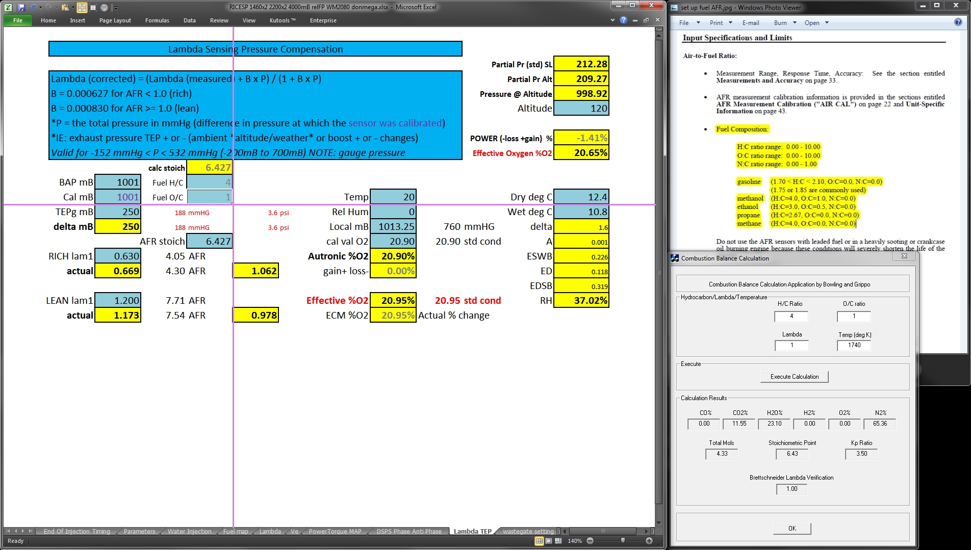

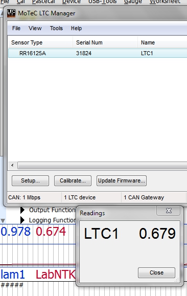

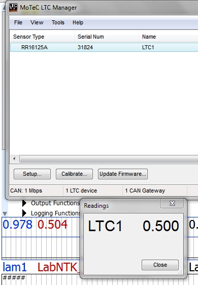

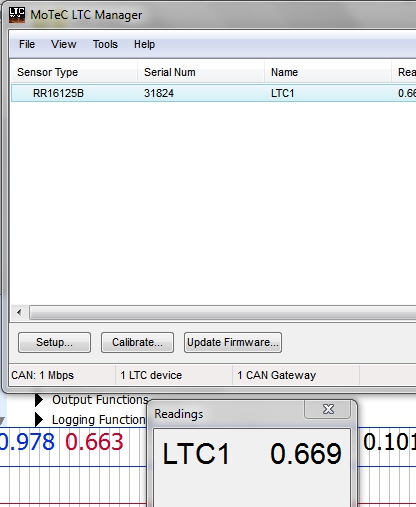

For all the MoWreC mother loverz out there I have completed the work on the 'Jimz Bagz' MoWreC supplied #57007 sensor
this is proven to work on methanol now as shown below, each one comes with its own sensor calibration (sensor name file and custom table), reach around to me and I will accommodate you....
I have some other arousing developmentz coming which will make everyone hard, stay tuned.

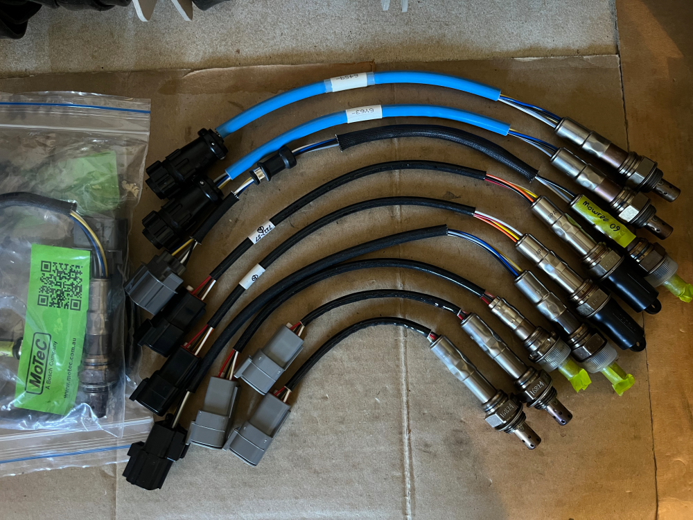

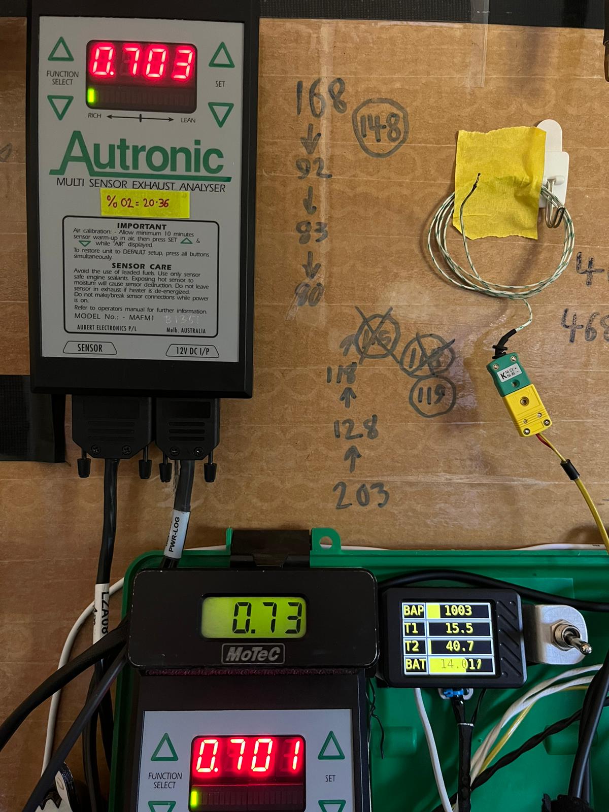

Just a small sample of the RR bench sensors, could not fit all in pic as 3 on test rig and another 2 on the ETAS meter
14! of these kuntz all up.......
A few of the 'leb grade' with cal cert are $1200 USD each !
and 7
high end meterz, a few I have $12,000+ USD each !
some talk about testing, others do it for real, no arsebook
Stay tuned for some fact v fiction debunking coming soon, not via 'claimed' industry expurtz, on pay to play, 5 day cert online coursez, GagTube entertainerz selling you food productz, hair balding treatments, or vitaminz etc etc........

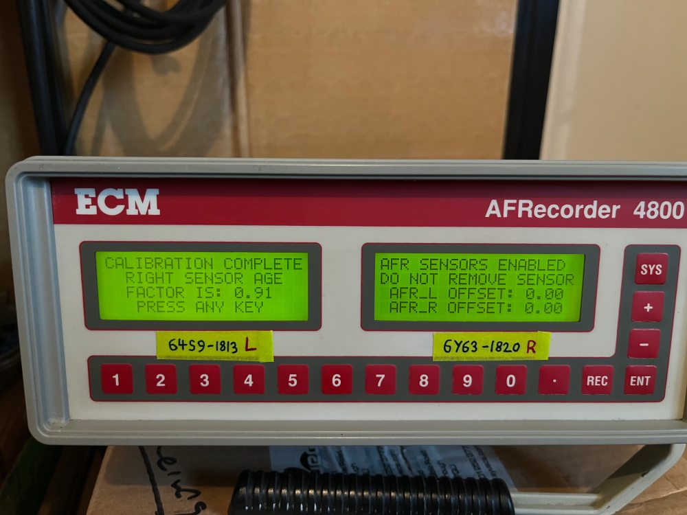

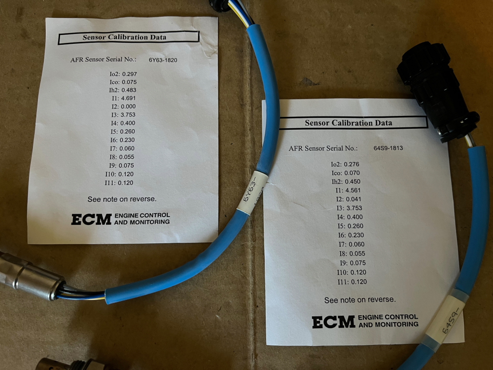

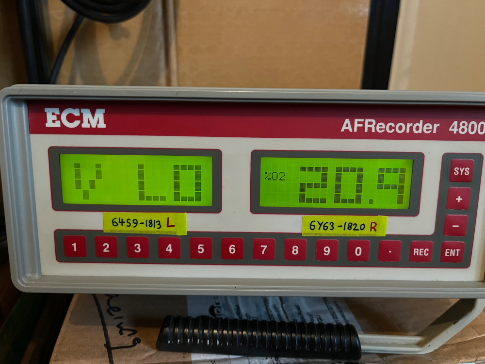

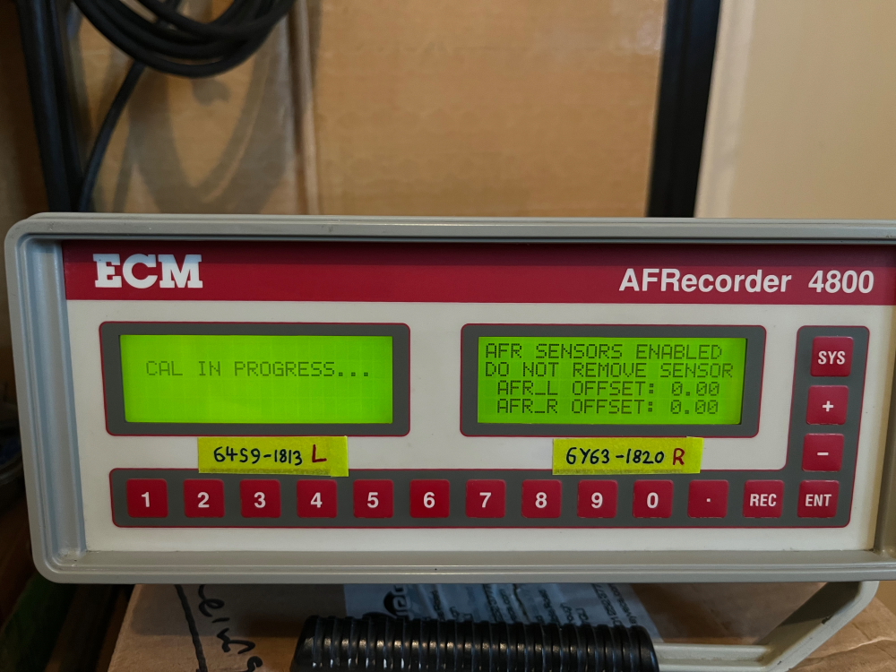

LAMBDA MASTER
for those who gag over this on the forumz and blogz, here you go kuntz, yes its here with all the otherz
fact v fiction
hype master
know what is accurate ? why the different readingz ?
'its just a number bro'
