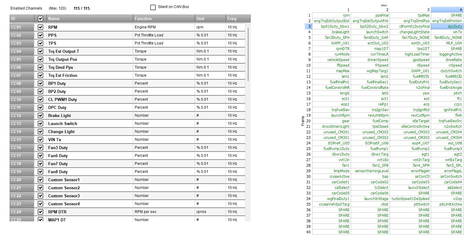

With the datastream on the Syvecs, and the likes of the CAN layout AIM have for their dashes.....why do the slots not seem to line up ?
Even as low as say position 13. On Syvecs this is position Brake Light, but on the AIM setup Brakelight is clearly number 12 ? And the errors continue
How are they so wrong ?
Do "SPARE" positions not get transmitted or something ? hence positions fall back every time there is a spare/unused slot ?
Even the .dbc file here seems to have units/config missing ?
Does AIM have an ability to display Limp warning messages ?
