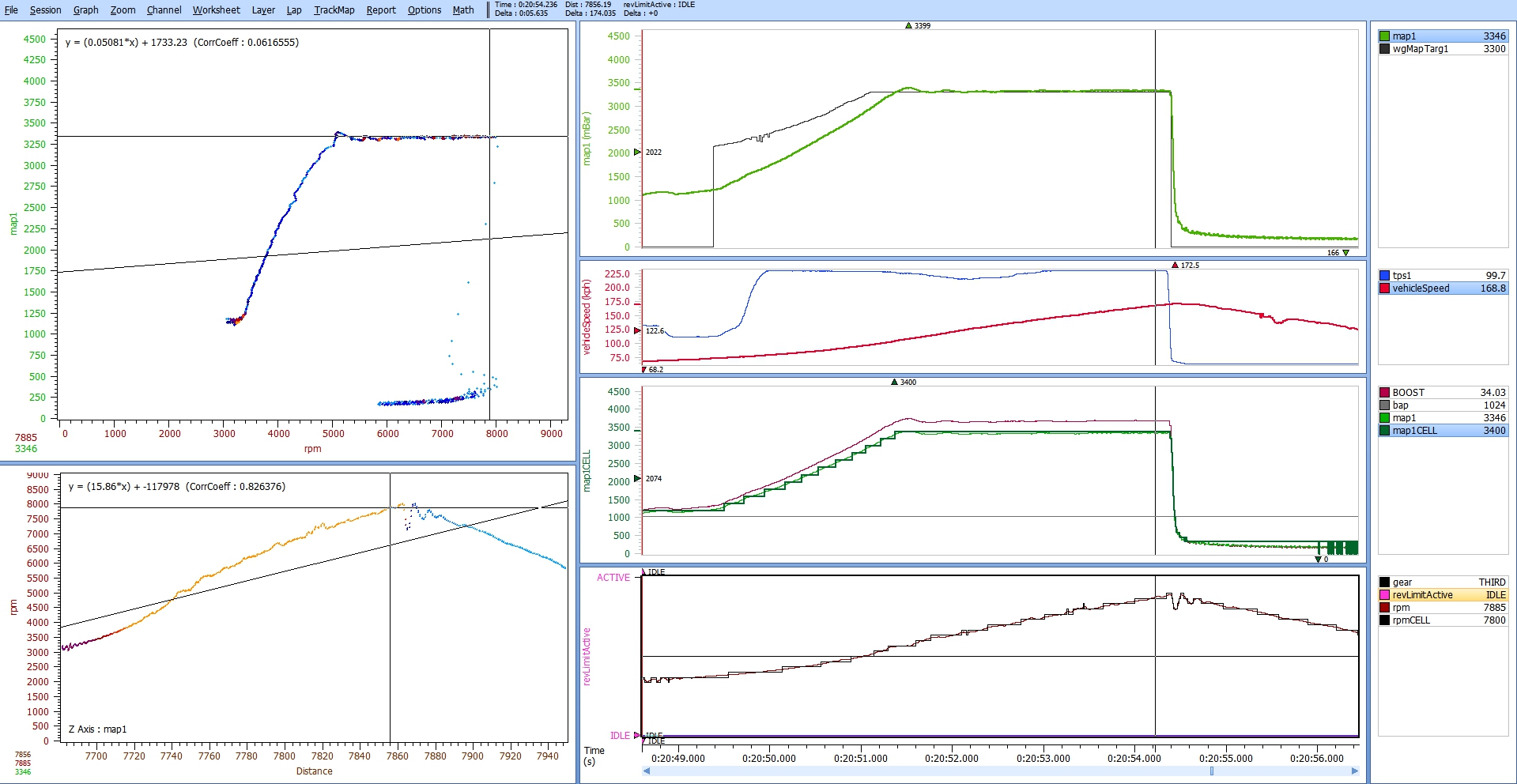

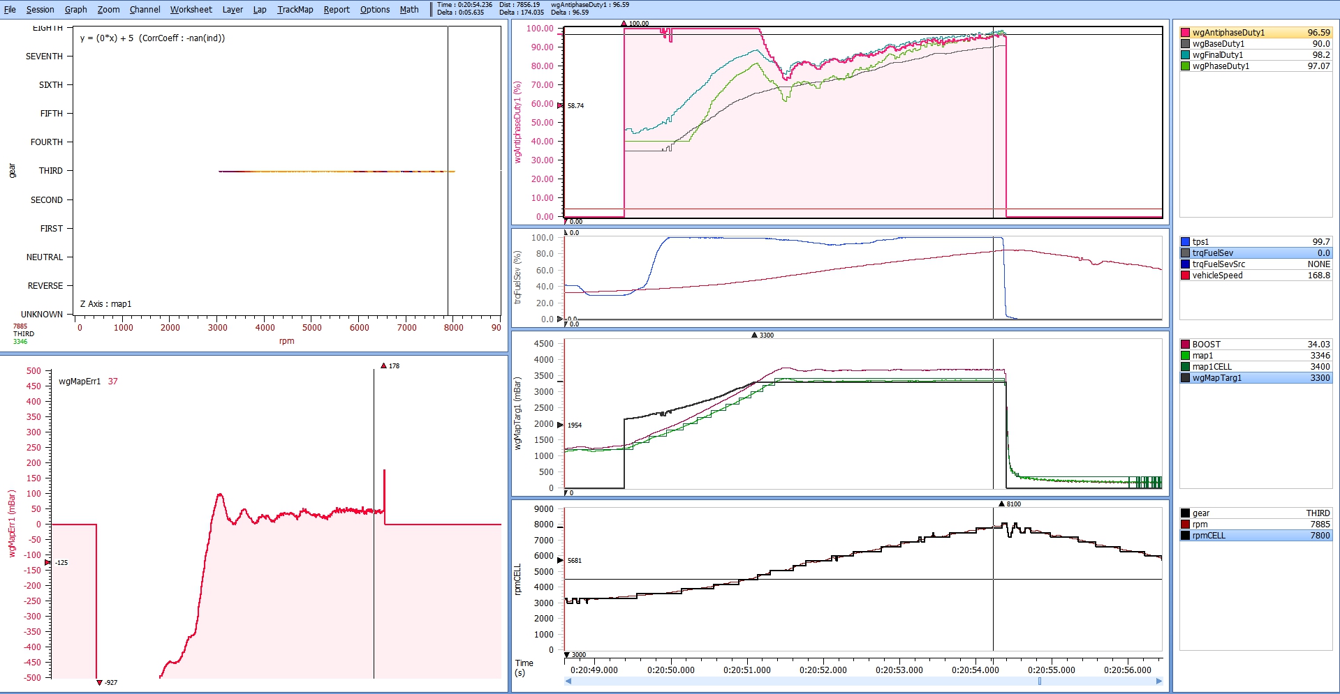

This is a car with one Pieburg valve set up and one MAC valve, phase anit phase. Have good control from 5% to over 95% 31Hz setting on this one.
