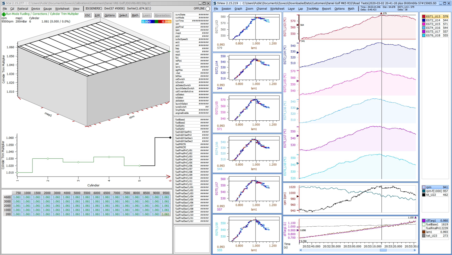

And here is the first iteration of cylinder balance, please note for newbies it has absolutely nothing to do with making the temperatures equal
This is the first iteration and once all cylinders are tuned you can then run it at 1.300 Lambda and idle smooth, cause all of them are making much closer levels of torque contribution thus the smoothness
Only achievable with RR donmega probes
p.s. Customer could not believe how much more refined engine felt and no hesitation on mixture test running at 19:1 AFR petrol scale on port injection !
