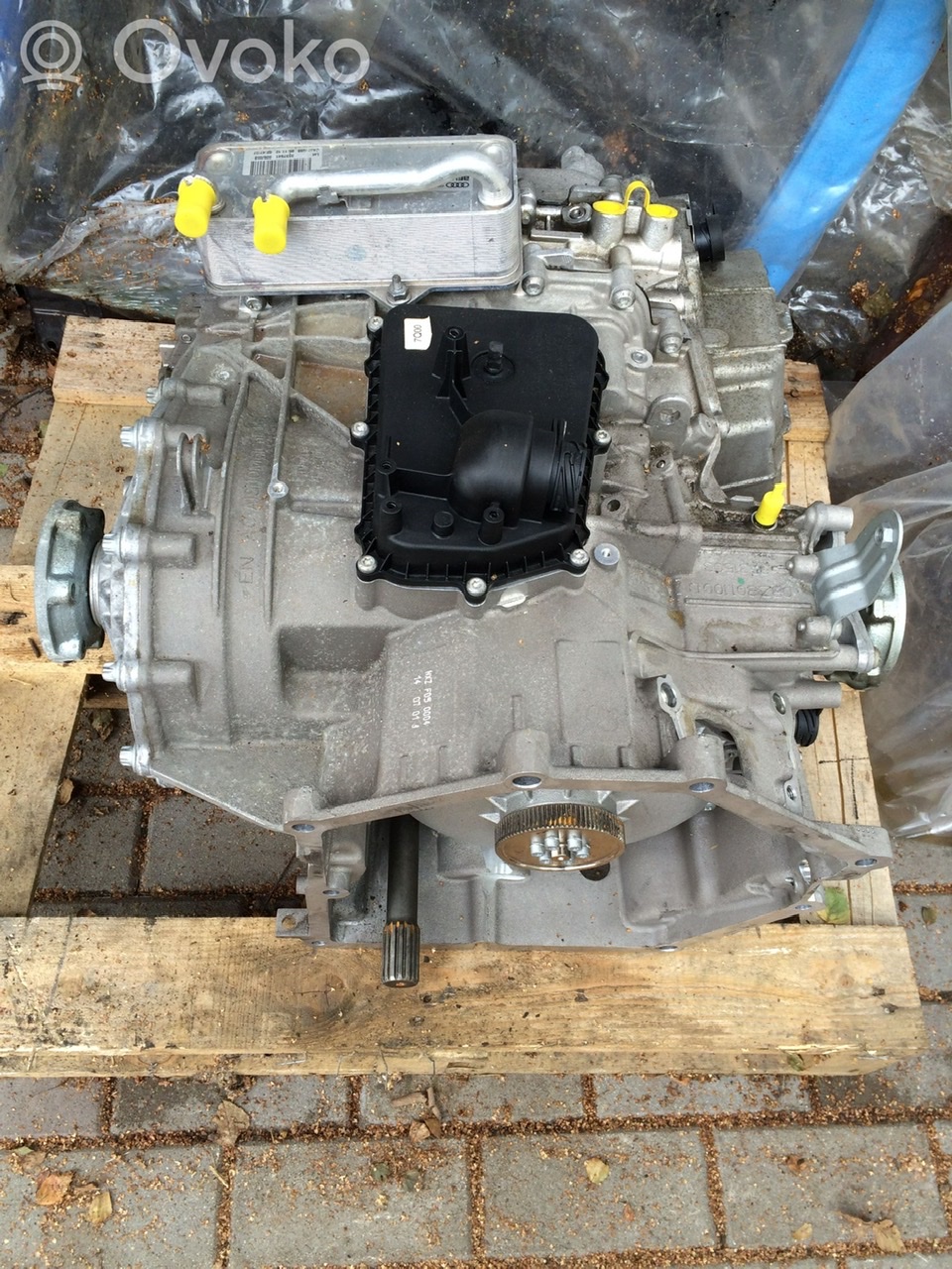

Hello I would like to have some information
I have a project to mount a V12 with an Audi R8 gearbox if I use your tcu and I buy a second-hand gearbox without harness is it possible to redo the harness easily?
Thanks
Best regards Alex

I think using it is a little more complicated than that to make use of a DSG type gearbox.
There are standalone controllers that you could probably use for the transmission that would then communicate with the engine ecu though. But using the gearbox directly, may require some of the integrated modules from the car too, that it would be expecting to get data from, or talk to as well.
But the FB group is a good page to ask on, as some of the tech guys do seem to be more active there.

Thank you stevieturbo for this answer
