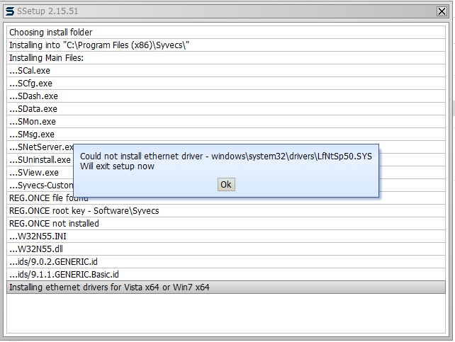

I get this error when trying to install ?
install error.jpg (38.23 KiB) Viewed 65045 times

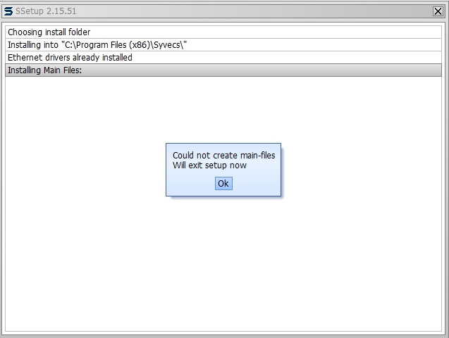

2nd attempt after partial uninstall yielded this
3rd attempt seemed to go ok...although havent tried to connect yet
Re: 2020-06-11 wont install ?
Posted: Sat Jul 04, 2020 1:26 am
image didnt appear ?
install error 2.jpg (89.2 KiB) Viewed 65041 times

A bit late to the party with this but I had the same issue; seemed that I had an existing instance of Scal running, and the network server.
Once they were closed all was well.
