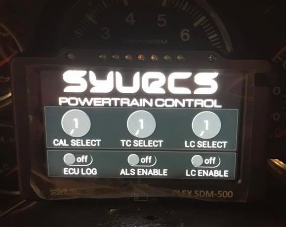

The new Plex firmware combined with the S8 is really a treat. We now full implementation of all 3 trim switches and 3 digital switches through the dash. The S6 and S6Plus are limited to a single trim switch. All of the switches are now user definable as well.

Yea, that screen never did work correctly with my S6.
That said, I would never want to use that method for actually changing cal anyway. I like the simplicity, speed, reliability of a rotary mechanical switch I can always get a visual on.
So I dont even use that screen at all now.
Although it's handy that the Plex does a pop up when you change Cal too.

I have a customer who wants to use those controls on his Plex, but has an S6. Because he will also have our GPS/expander unit, I will be enhancing the software to receive the packets from the Plex and transpose them to "virtual inputs" - so TC Cal (for example) might be in Slave input 20. I will add the same screen functionality to Toucan as well.
Minority interest, maybe, but might help others...means you can have control of much more, even on an S6, but does mean you need the expander to do it.

I run a Syvecs S6+ with a SDM-500 GPS Syvecs Edition in my Mitsubishi Evo and this combo seems no to work like advertised. :cry:
The cal-switches on the dash and the datastream back to the syvecs are not working properly. I can’t dial the maps via the Plex and the syvecs cant receive, for example, the GPS Data.

The Cal/TC switching via the dash has never worked as far as I am aware.
It can work for the S8 I think though, but the S6 CAN is the limitation. But TBH....a nice mechanical switch really is a better option.

I first ran my Plex with the base S6 and it could certainly receive GPS/Accel data etc. The Cal switching never worked, but that didnt bother me as changing Cal via the screen/joystick of the Plex would be a nightmare when actually driving. Seems more a novelty than an actual useful function. And when racing, little beat the simplicity and certainty of a click switch/dial.
