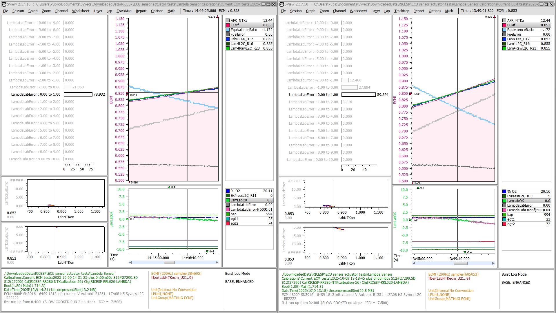

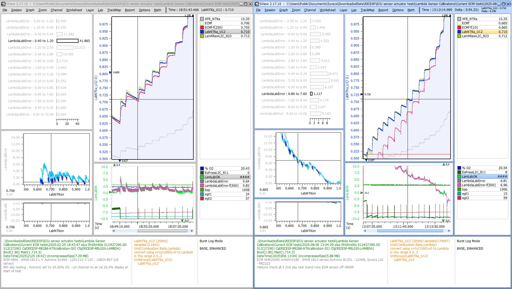

Interesting test
ECM 4800P (on left)
ECM AFM1000D (on right)
same (new) sensor into both unitz........... gave different readingz
refit old used sensor totally different (reports below)
all set up as per instruction - no indicated fault on either sensor
was going to try another new sensor but seen enough and packed it up to return to customer :)
HIGH END
ecm error master1.JPG (890.4 KiB) Viewed 180437 times
ecm error master2.JPG (819.53 KiB) Viewed 180437 times
old new sensors.JPG (529.56 KiB) Viewed 180437 times

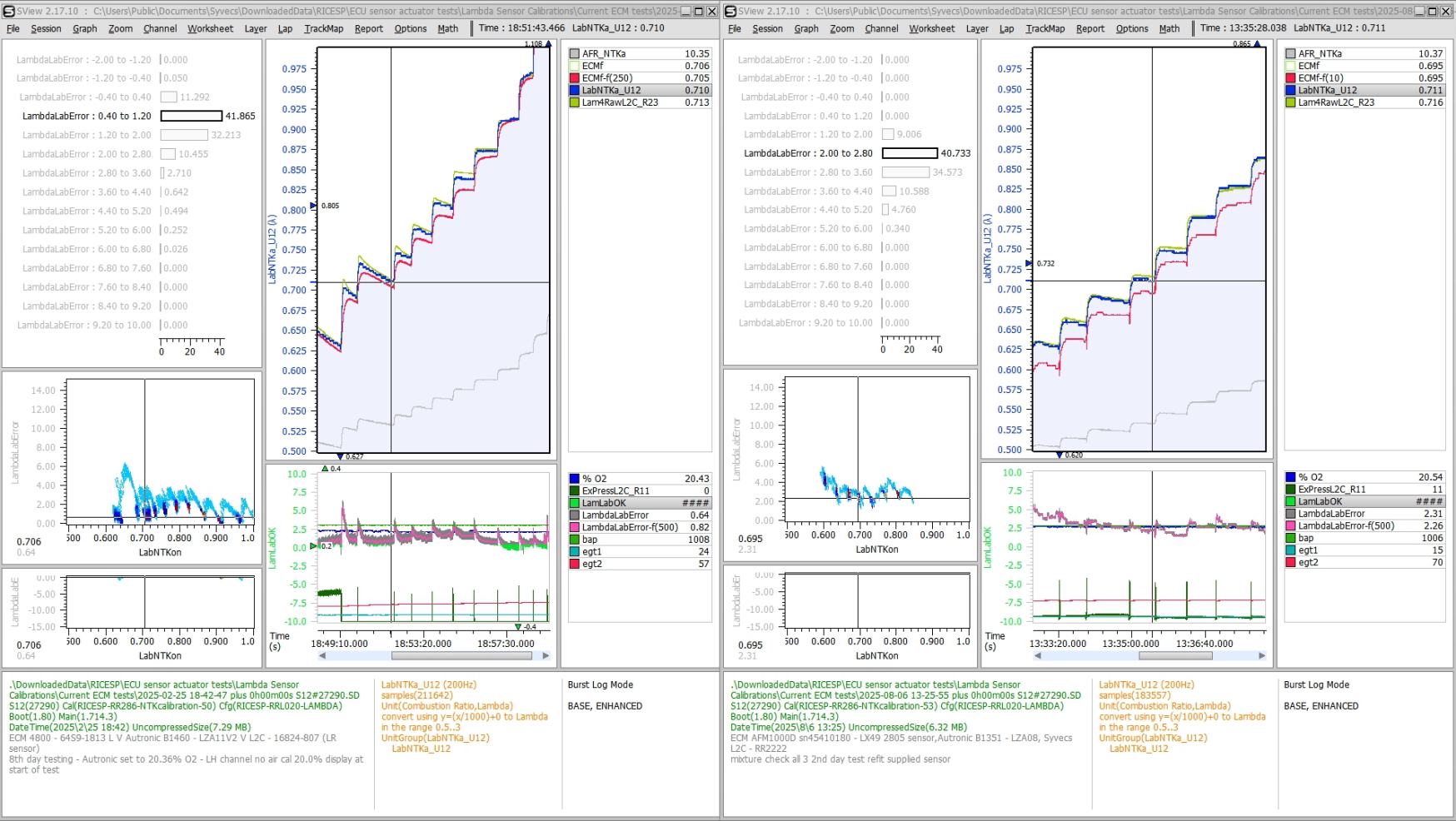

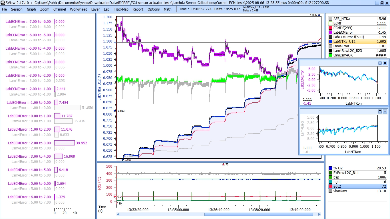

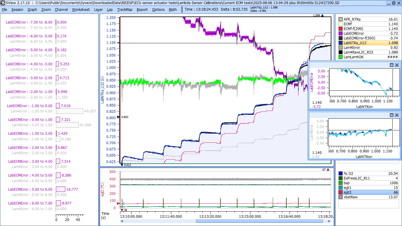

Posted: Thu Aug 07, 2025 1:55 am
My std report format which shows clearly the errors in common use ranges, full rich its basically fake newz
same sensor tested over two different days

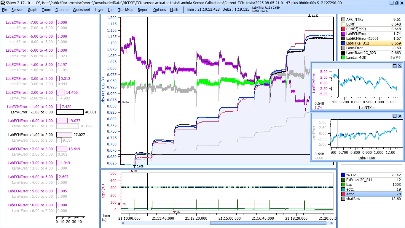

Posted: Thu Aug 07, 2025 1:56 am
and my new sensor fitted to the AFM1000D V it running on my 4800P
Posted: Fri Aug 08, 2025 4:41 am

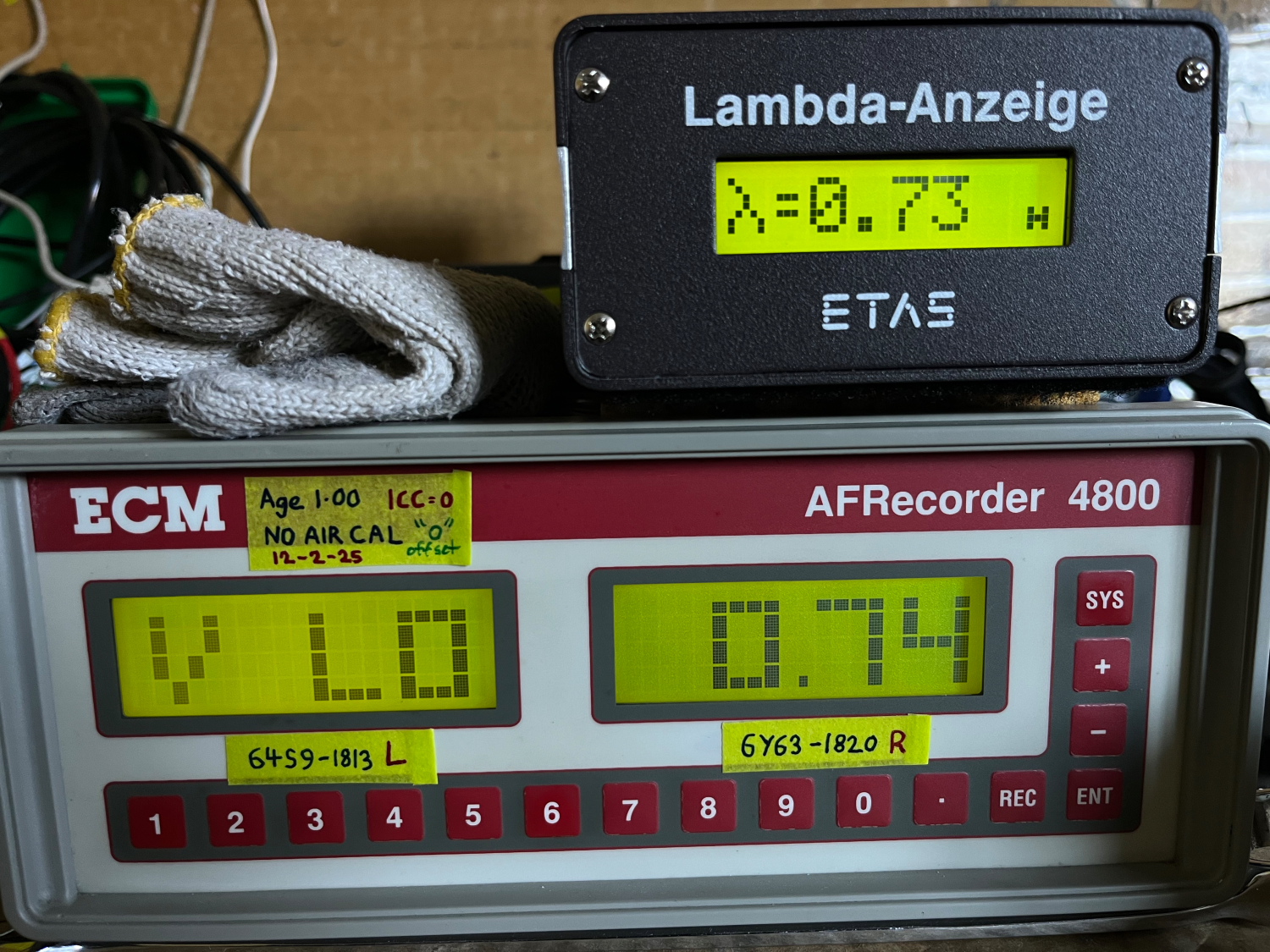

Posted: Fri Oct 10, 2025 11:02 am

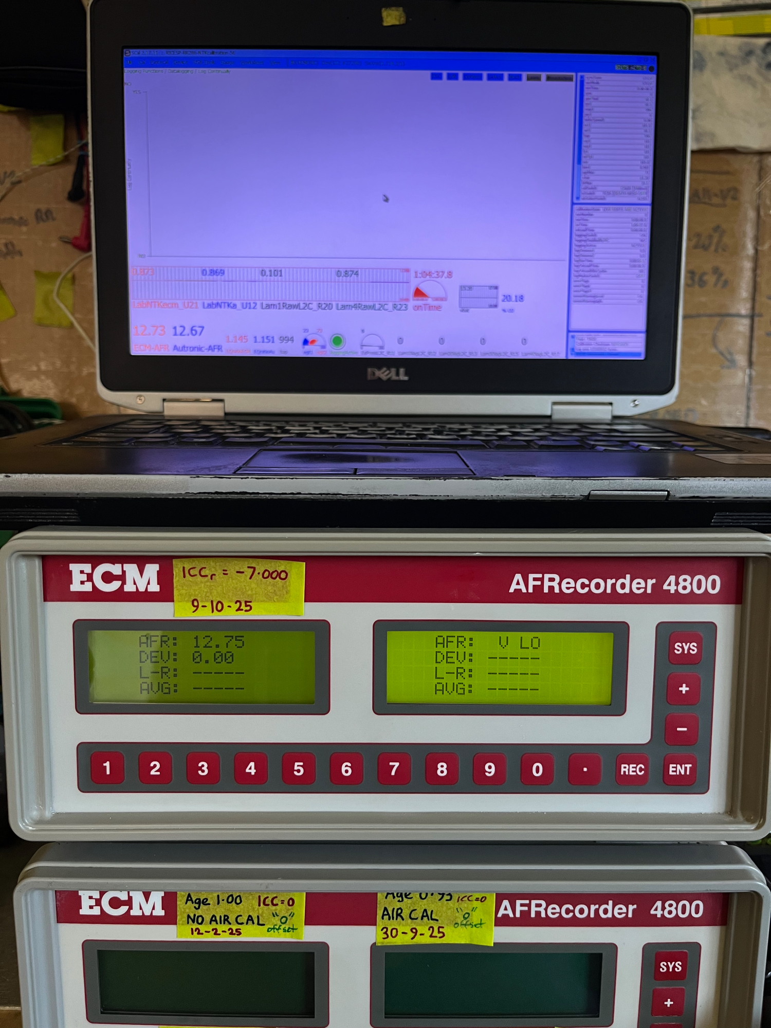

Been chained up to the dyno and bench for ages and not much time to send an update here.
Some may find this arousing?
Will be a while before I can do another Tik Tok but some happy snapz showing some testing and further development, enjoy, and yes I own two of these along with many many many others! way too much to post but will school some kuntz soon on Gag Tube :)
hype master1.JPG (593.81 KiB) Viewed 158455 times
4800-B 5.jpg (1009.7 KiB) Viewed 158455 times

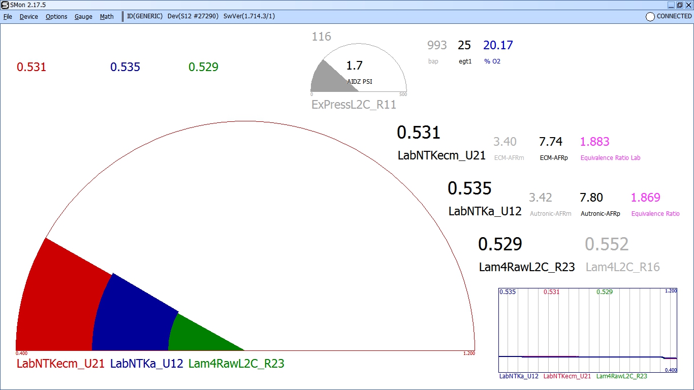

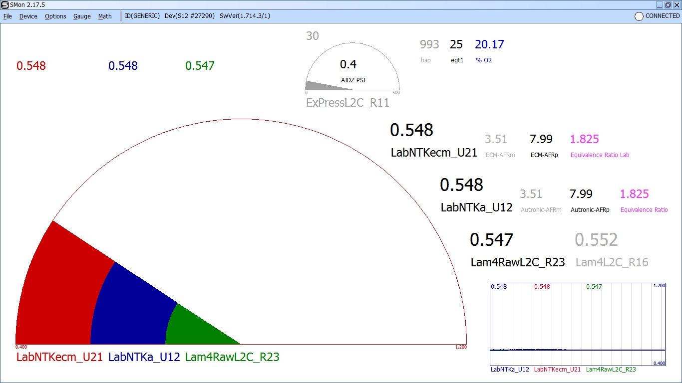

How good is the syvecs lambda to can 8 channel unit?
when fitted with a RR calibrated sensor its the don, especially when you factor in that one of the largest sources of error is the pressure that ALWAYS!!!!! exists in the exhaust system of every car.
