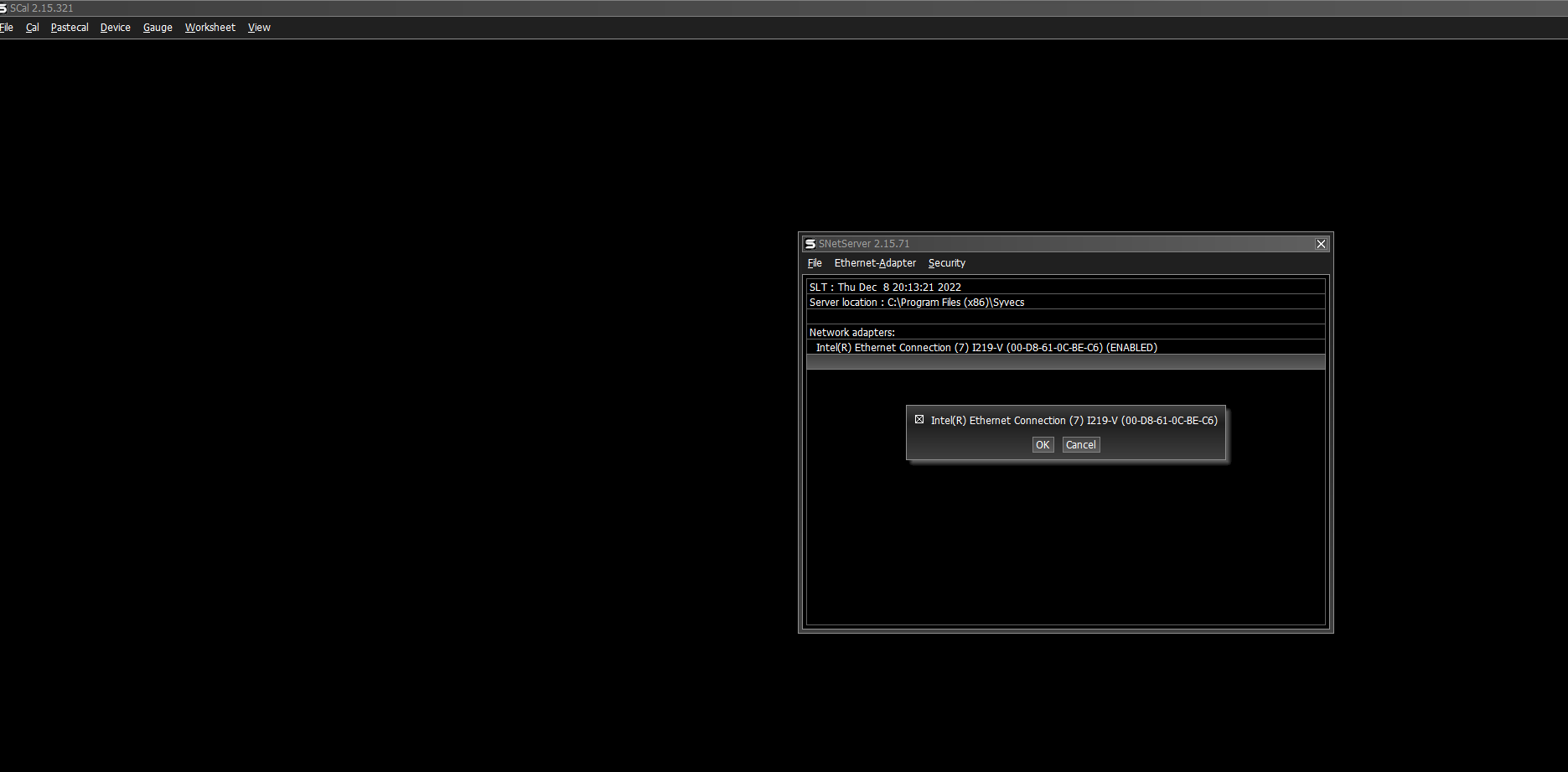

Do you see an adapter when you open SNetServer? (run as administrator)
- snet.png (31.8 KiB) Viewed 32219 times
Re: Hey neex help connecting to syvecs
Posted: Thu Dec 08, 2022 8:19 pm
by Twinturbosyvecs
Yes i do
Today tried another pc with same results will be sending to wayne to diagnose
