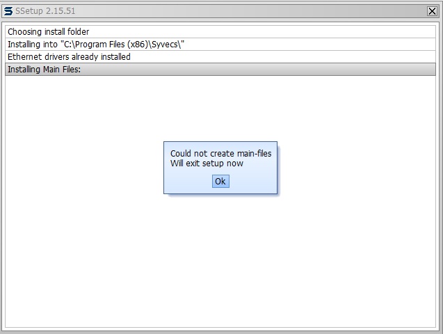

I get this error when trying to install ?

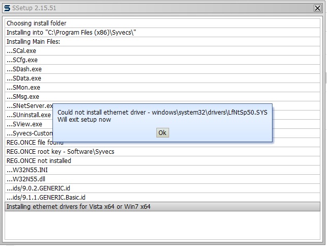

2nd attempt after partial uninstall yielded this

image didnt appear ?

Mine updated without issues on two different computers, for what it's worth.

My desktop PC went ok...laptop had the issues.

A bit late to the party with this but I had the same issue; seemed that I had an existing instance of Scal running, and the network server.
Once they were closed all was well.

Worth noting that on my laptop....it would not communicate with an ecu after I installed, but one install attempt did say the comms drivers had failed.
So I re-installed an older version, it communicated, and then I tried again to install the new version, and then it communicated.
No idea what's going on, as never had issues like that before with any other install.
