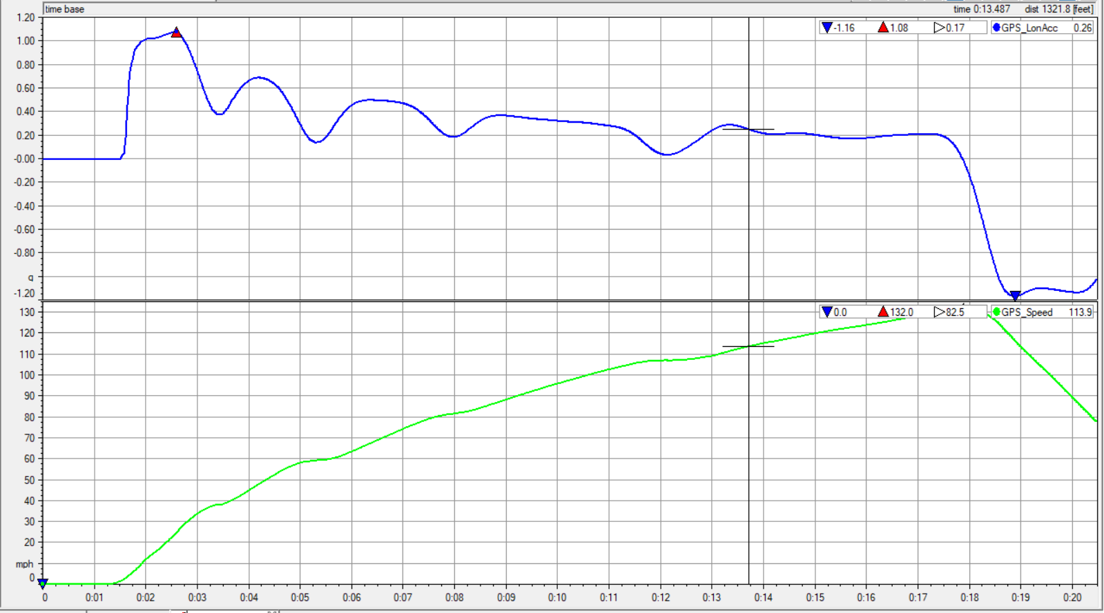

Hi Stevie,
I just use the stage exit at hold timer set to 0.01s, so it switches out of stage mode as soon as the clutch switch is triggered and the hold timer starts to count down.
There is effectively a small lag time from the moment the clutch starts to bite to the moment the switch is changing state because the switch is at the top of the pedal stroke to enable the flat shifting to work properly, but that doesn't introduce any issues to the launch, when triggering off exit speed only it was bogging as it tried to stop the engine revs and boost going over targets required when stationary.
To make the launch strategy perfect, you really want the launch switch activating at the clutch bite point further down the pedal, but as i share the switch for both launch and gear cut strategy, it needs to be at the top, otherwise the torque would be introduced too soon on flat shifts and you would get some clutch slip, which will wear the clutch out sooner.
What used to happen was the hold timer wouldn't start until well into the launch, the car would stop accelerating as you describe, then it would pick up again. It was loosing me a lot of time if you compare the launches.
I'm using an organic clutch as it's my daily driver, so don't launch the car with huge torque, only 1 BAR boost, but it's spinning up all 4 tyres and pulling 1.1G on road tyres on normal tarmac now. It could be quicker if i had a better clutch and was prepared to risk the drivetrain. It's quite impressive for a full weight road car with stock transmition and an organic clutch. 0-60 is 3.7s and 1/4 mile is 12.1s, anyone who knows how slow my shifts are would see that as pretty good for a proper road car, with me onboard it's weighing 1560Kg and has about 460BHP/lbft on pump fuel. Tyres are 235/40x17 Michelin Pilot Sport 4, just a decent normal road tyre.
The trace below is from my AIM Solo GPS logging doing a standing 1/4 mile on average grip tarmac and then straight into a flying 250 metres. The most I've seen is 1.19G on a fairly rough tarmac surface. I've not launched the car on a high grip surface, but limit is my clutch anyway.
