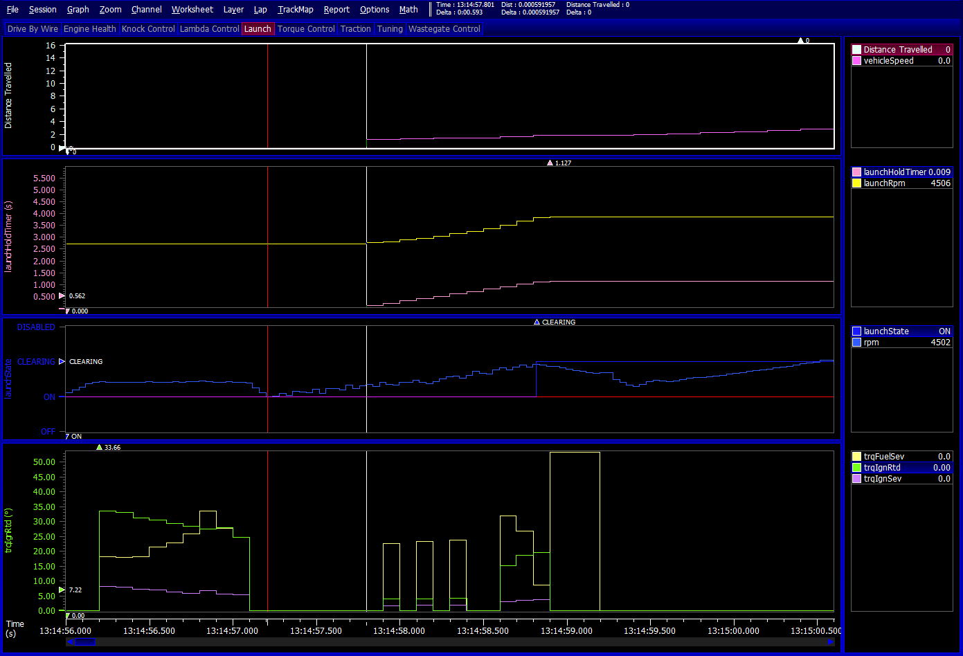

The launch exit speed is the trigger that takes out of "stationary launch mode" (my term) and starts the hold timer going. While you're within the launch hold phase, the launch limiter is applied using the "Launch Control/Base Engine Speed" map which is RPM vs hold timer(s). The launch hold timer has a max value set in "Launch Control/Launch Hold Time" and once the hold timer reaches this value you are out of the hold phase, and into the exit phase. The launnch exit phase lasts as long as the time set in "Launch Control/Launch Exit Time" which is currently 0 on your car, but can be used to set launch specific boost target limitation and/or nitrous duty adjustment.
You can see all this happen in the screenshot of your log below
Since 2014 Syvecs firmware has improved massively in this regard, and I've improved what I do with it too. With your car we still have the problem of it being 4wd and spinning all 4 wheels, so the launch hold time is the way to go (with Syvecs). I would recommend you look at updating the firmware to add the Stage and Launch individual phases, and I would also work on using more retard and less cut. You're cut tables already do this to an extent but with more tuning it can be improved.
