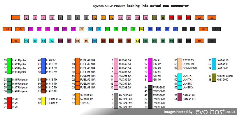

In manuals and pinouts it gives a picture
http://www.syvecs.co.uk/support/product ... d-pinouts/
Page 2 of the manual
http://www.syvecs.com/downloads/Syvecs% ... 20V1.1.pdf
Although your image is very clear which is handy

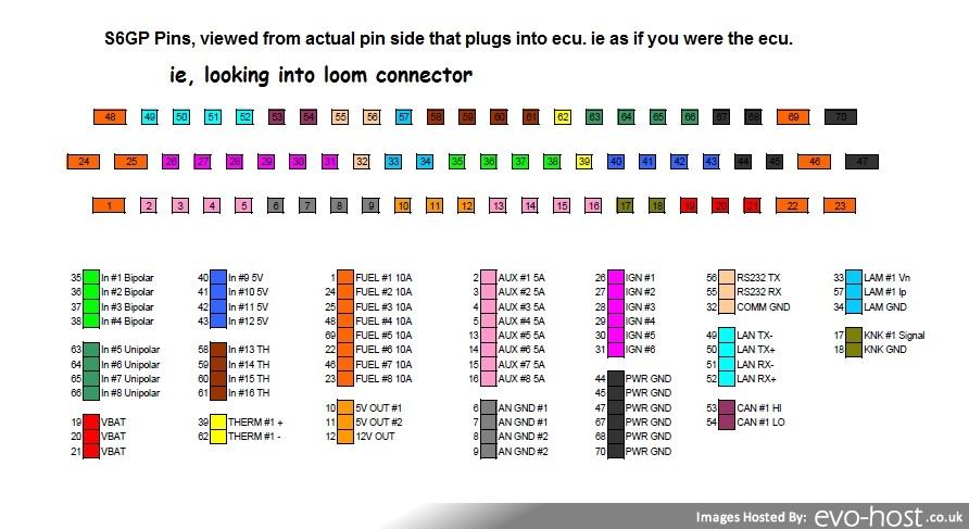

Or this, I just reversed the image, so it refers to looking into the actual loom connector which can be handy tracing pins on the loom ( although might need to hold connector the right way up lol ) Once you know where 1 is, it should make sense I think
Or looking into ecu

Nice! would have saved me a little time (only a little - didnt take that long
Well Ill leave the image on there, it may help others in the future
