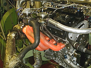

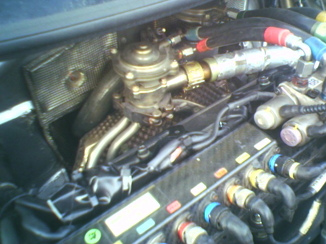

KISS... Keep it simple stupid. No diffucer, just plain pipes from auxiliary air valve. Air entrance from cold side of IC and some ecu control strategy. Picture from 2002 Peugeot 206 WRC. Cold side feed, helps to prolong ALS - at least few milliseconds longer, before melt down.
206 engine dyno.jpg (35.04 KiB) Viewed 46171 times

Benkku
Posts: 50
Joined: Tue May 03, 2011 12:30 am
Re: anti lag
Post by Benkku »
Those (Subaru and Peugeot) systems definitely, are NOT EGR system's in any way. But effective auxiliary air systems - you can't get enough air (air/fuel mixture) using idle speed air valve to keep up turbo revolutions.
