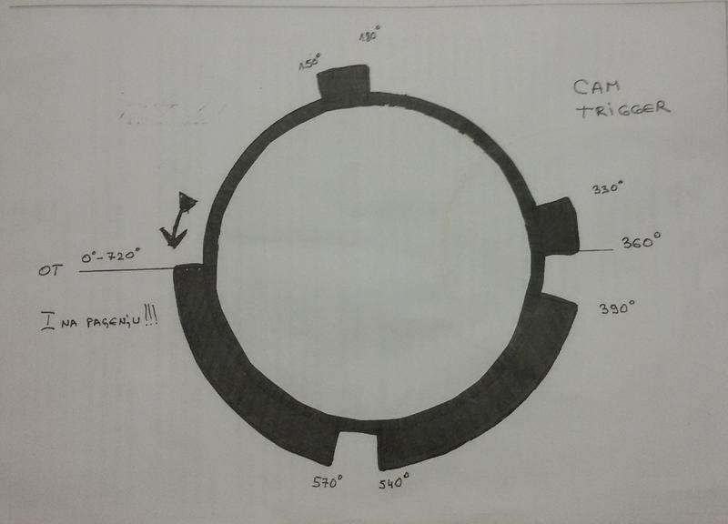

Hi,
I need help with Manual Cam Checklist configuration. I read and tried all I funded on this forum but no luck. Crank trigger is 60-2 and it is working alright. Cam trigger can be seen on picture. There is no VVT. Both crank and cam sensors are hall.
Engine is with direct injection so 720 sync is needed on cranking before start but I can not get it.
Thanks

Can you do a scope trace with a spark plug in cylinder 1 only ?
It's easier for me to visualise what to do that way, and should be able to see where cyl1 is on the trace.
Posts: 1407
Re: Manual Cam Checklist help
ok...try this...and i'm taking from your arrow that the small tooth on top will be the first tooth seen during normal rotation.
checklist entries = 3
Angles, 90, 180 and 350 ( I'm basing this on a rising edge trigger so if you are not using this, it will change )
Counts phase 1, 0-1-1
Counts Phase 2, 1-0-1

Thank you.
I will try later today.

It works. Thank you very much.
